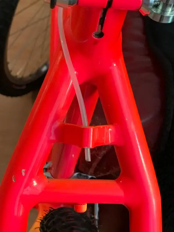

Got it out with a little screw :)
I had this problem with a 2002 Attitude this year. I tried for ages with magnets to no avail
In the end I used some dental floss and the hoover to get it through (worked almost instantly), and then tied the inner cable to the dental floss and pulled it through.
Outer cables only went to the entrance and exit.
So let me get this right i bought a early klein frame stripped but it still has milky colored plastic tubeing sticking out of all 4 holes i assume these are original to frame and are there to guide cables throught frame i though you pushed your cables through frame then pushed these milky tubeing back into frame when done i am supposed to leave in or take out cheers
I think you are right you push your inner cables through them and then slide them back in
