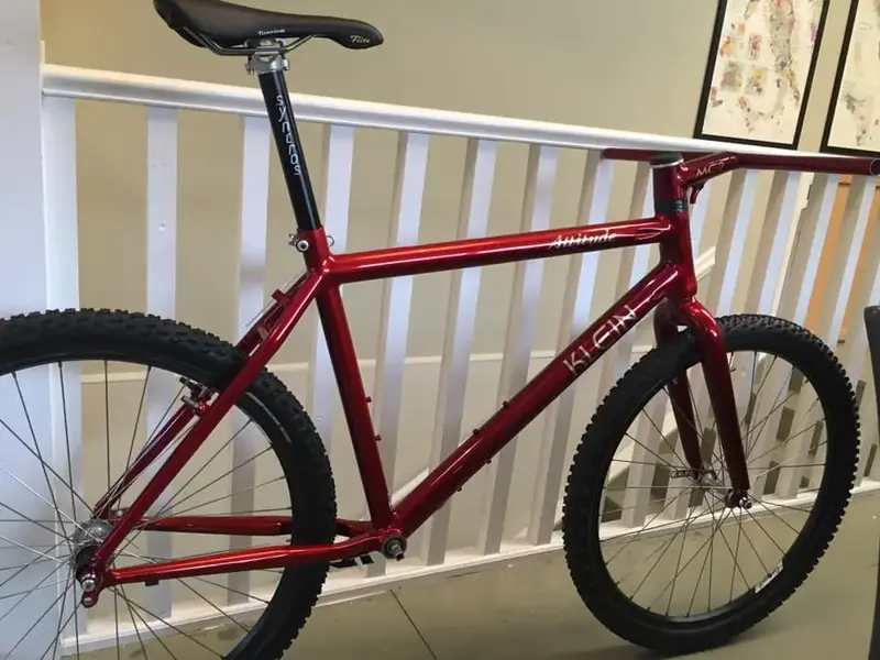

Arrived!
I must say the colour in the flesh is phenomenal and so vibrant.
Is that a Candy coat finish? it's awesome.. :D
I think its candy colours used to make it, the over all scheme is a Klein colour called Painted Desert. I think it was available as a colour around 94/95.

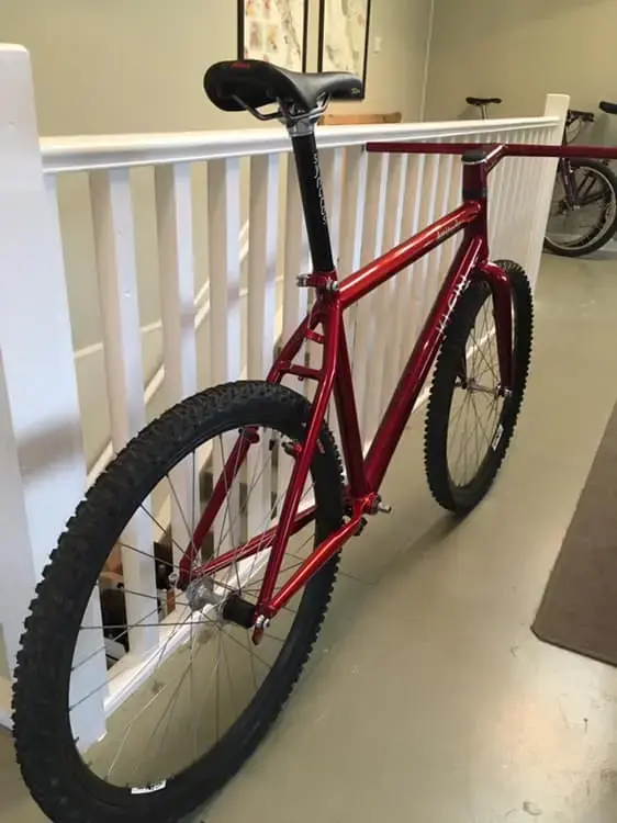

Firstly i have sat the frame on its wheels.
XTR M900 hubs with Campagnolo Stheno rims and Ritchey z Max megabits tyres.
Going front black colour theme for most of this. Hubs are silver as are the Ringle skewers.

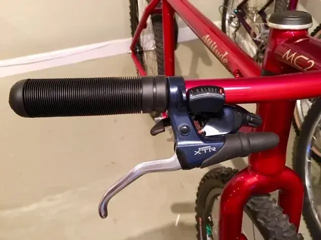

So i've source da lovely pair of XTR M910 NOS shifters and some Onza Attack Mushroom grips, and mounted them on the handlebars, they look fab.
Love the combo and like that the end of the bars are now protected.
