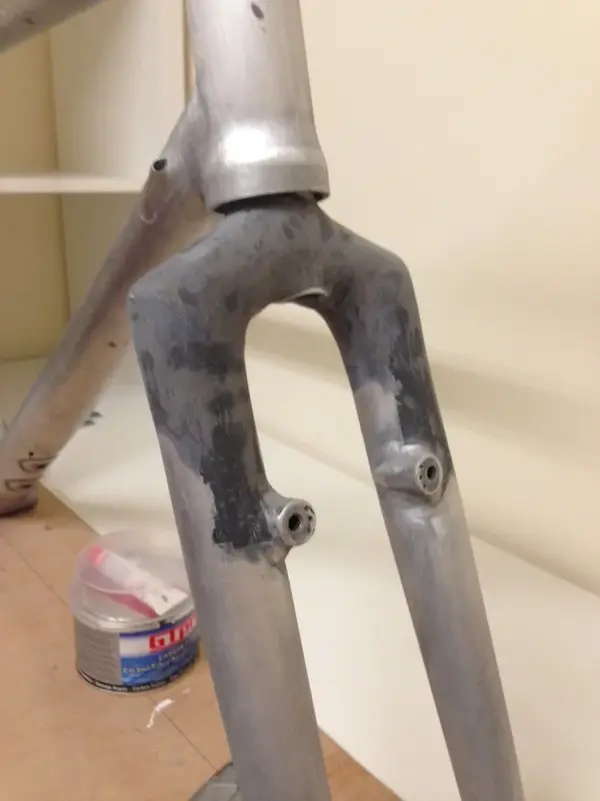

Well I have got the carbon on to the fork! Looks a bit mottled with the filler on but getting there. A bit more work and I hope the smoothed out crown will look good once painted!

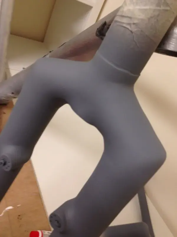

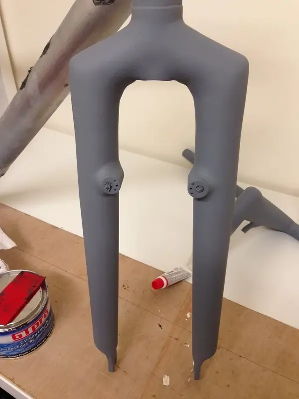

You guys are so demanding :) I have entered an endless cycle of sanding and priming in search of perfection. I am concentrating on getting the fork crown looking ok then will move back to looking at the frame
I always thought the boxed fork on the early Adroit did not have boron/carbon-epoxy but was identical to the Attitude fork (which was prone to crack)
The boxed crown fork is all I have. I have cracked one before so they are flawed. However I have also ridden another boxed crown fork for nearly 20 years and it has held up ok.
Interestingly there is one of the original Adroits on oldklein.com with a box crown fork and it is listed as being carbon re-enforced.
