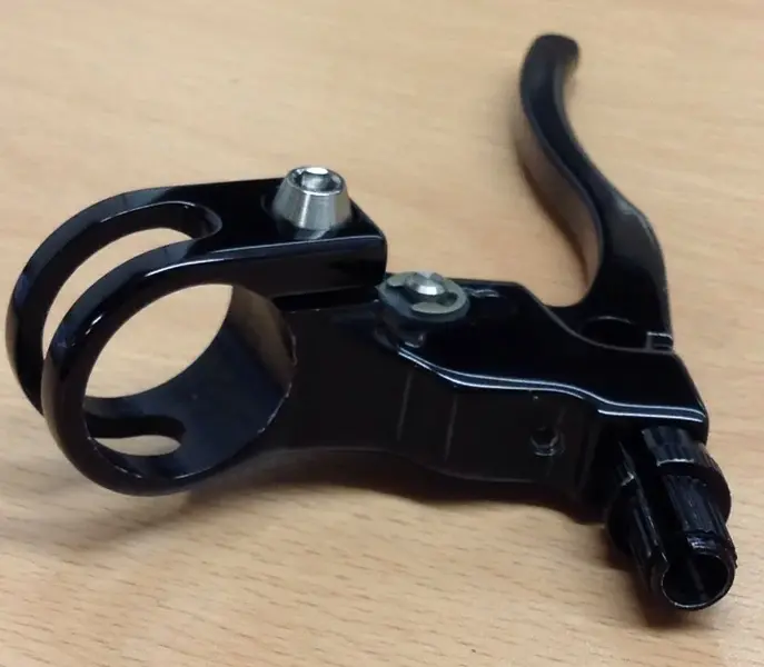

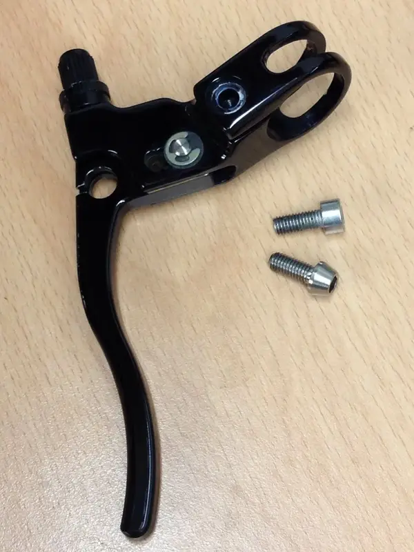

I fitted some new ti bolts to the levers too as the ones they came with were chunky and steel only to realise later that the proper original bolts had a dome head so got some dome ones coming now.

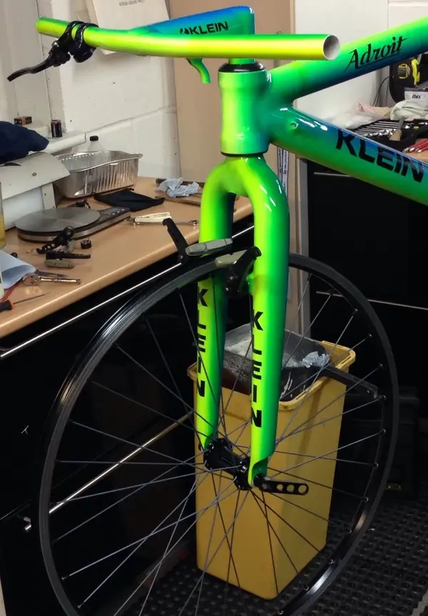

Started hanging some parts on last night at last now I've finished messing about with those cranks! Was going to fit some new Scott Mathauser pads but they don't fit on the forks, there isn't enough room between the brake and rim so using some grey Kool stops instead. The rear left brake would only go onto the stud half way, there was the smallest of burrs in the brass sleeve of the brake stopping it sliding on so that needed some careful filing with a needle file.
Hoping when I do some today I can get a bit more of a flow on!
