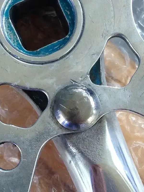

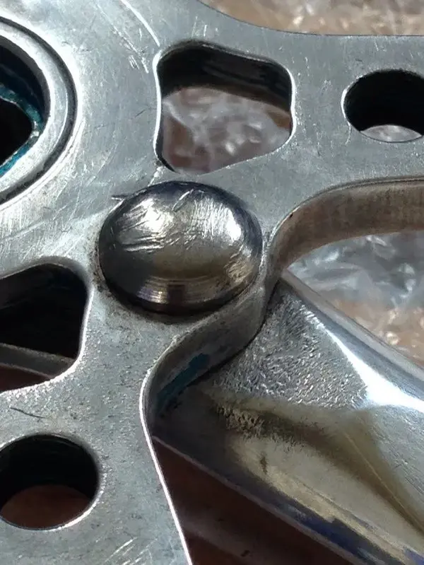

Interesting, had a few opinions at work and it seems to be stainless steel. Here's some pics, if there is a thread in the arm then I'm happy to drill if out and source a new bolt, anyone have any other images of Toplines showing the same area?, wondered if these were different for some reason. Thanks for help.

From the images I've seen most were assembled with the rivet but some did have a bolt in.

Of course, probably will, I'm going to put up a thread in chat and see if anyone has ever removed the spider from a rivet type one, I'm tempted to do it anyway and hope there's a thread and if not put one in and get a bolt for it. Cheers for help again.
I had the same problem years ago,
in my case, the screw was titanium. :shock:
was torture to drill the screw :facepalm: , we thought it was steel but after several hours, we saw it was titanium. crazy to remove it, although a skilled mechanic, having good tools and materials I would not try ...
There are two models mentioned. one screw and another model riveting.
Thanks for info, could be Ti as it has a slight grey colour, it's non-magnetic and very hard. I'm an Avionics aircraft fitter so have the means around me if I go down that road.
