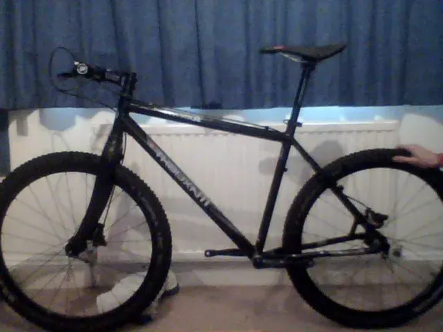

Right forget waiting for the ring, excuse the really really crappy webcam pics, but it was easier that way :roll: . I know the geometry is a bit dodgy but I quite like the look of it even if I say so myself. Cables still need cutting but that'll be done in the summer when I have more time.
Only things left are groupset and rotors, pedals are coming as a birthday present which I definitely didn't see lying around the house :LOL: :facepalm:
I'm aiming to finish it by the beginning of next year so I can get out on the trails in the spring and after Christmas for what will hopefully be some great xc riding.

Thanks!
I got the Picasia ones in matt and they look stunning, they were £107 which I decided was better than a cheap sus fork for that price. They also weigh 460g on my kitchen scales with an uncut steerer, I just hope they don't disappoint...
They're also physically identical to the Ritchey and Token ones which apparently used to cost £££ when in production, I'm guessing the likes of trigon and picasia have bought some of the moulds from the factories that produced them or something?
Holy moly thats light wish I'd got some of them on my merlin malt kenisis frame.
