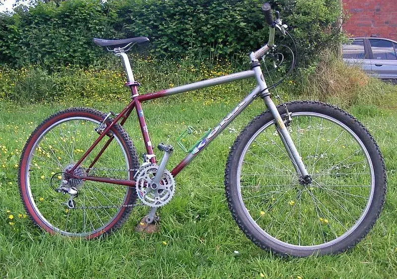

The only Kona that had those dimensions was the 1993 size 19 - I don't suppose it has two-tone red and silver paintwork, has it?
The 93 frames were slightly shorter than subsequent years. From 1994 on, it was the size 18 that had a 56cm c-c top tube, and that was designed for height up to 6-0. If you're taller than that, you could obviously go for a bigger size frame, but one thing to try first would be to raise the height of the bars. I'm assuming you have a zero-rise stem and flat bars at present, and combined with the shortish RC35, that could well be making for a front end that is too low for you and engenders that A over T posture.
Yup, red and silver two tone.
I have fitted raised bars, but in the original stem that is quite flat.
I worry that if I go for a longer stem that it will put me too far forwards again?
I am 6' 2" with a 32" inside leg and long back, which doesn't help with the weight distribution!
Perhaps I should go for a steeper stem first? Any recommendations?
Well you're within the recommended height range for a size 19 Kona (up to 6-3), but with a long back it's possible that you might eventually be better off with a size 20 from a later year. Your bike is fairly desirable to the market, as the two-tone 93 paint is popular and the RC35 is a significant asset. So you should be able to buy a size 20 Kilauea/similar for the same kind of money as you'd raise by selling the one you've got (est c£300).
As far as modifying the 93 bike is concerned, you are a bit limited in stem choice because there obviously aren't that many quill stems around. Rather than recommend one, I think it's a matter of keeping your eye on the for sale here and on eBay and posting a wanted ad on here. Another limitation is that the 93 frames were the last that weren't suspension-adjusted, so although it's fine with the RC35, it wouldn't be quite so happy with a longer fork. So that frustrates another possibility for raising the front height.
Just as an example, the 1994 size 20 Kilauea shown below is currently for sale on eBay. Compared to your frame, it has a 2.5cm longer top tube, a 2cm longer head tube and it is suspension-adjusted, so you could fit a longer fork to it. That would get the front end significantly higher and give you a better posture. That sort of thing could be your eventual solution.
