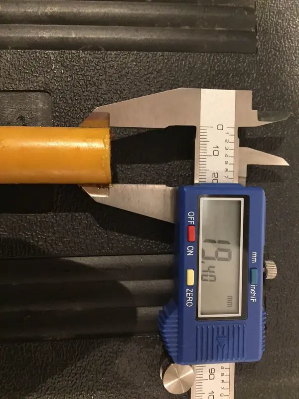

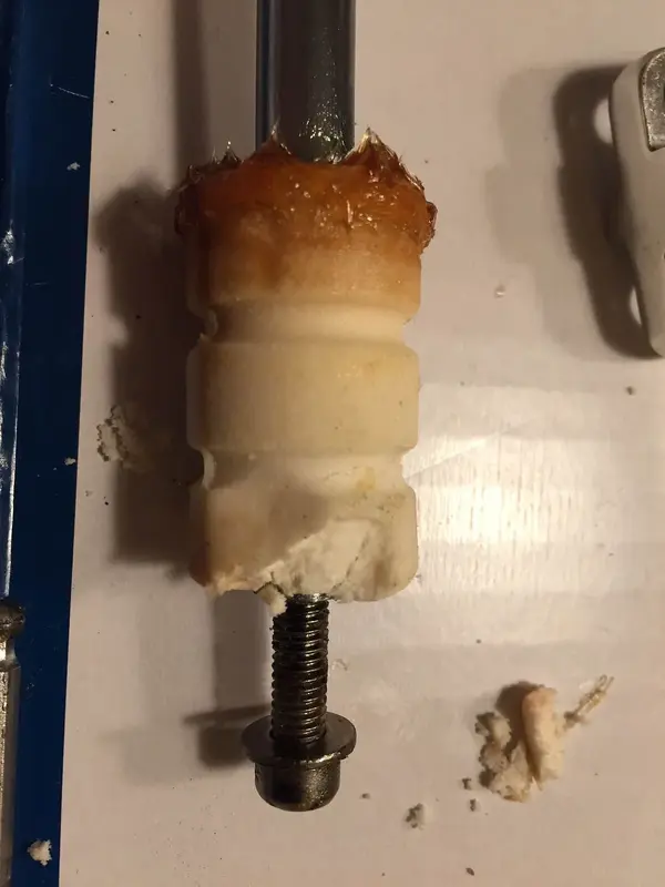

Hi all. I'm doing up an old Kids Zaskar and I'm hoping someone can help me. I need to replace the elastomers in an old pair of Ballistic EX500 20" forks. The elastomer is rock hard (unsurprisingly) and there was an unidentified foam end that disintegrated when I touched it. Any ideas where I can get the materials to reform/replace. Pics attached.

Wow, amazed you managed to find som of the original Ballistic forks. There are quite a few threads on here about sourcing hard to come by or cheap elastomers. You can just buy regular polyurethane (PU) rod or tubes. Thing to look for is the shore hardness. Regular forks take something around the 40A mark — guess you’d want something lower for a child’s bike.

regarding the foam; that looks like top/bottom out foam as you'd find on car suspension. I've actually used old top out bumpers from a car and cut then to suit forks in the past. You just need something big enough to cut out the required amount of material, I used old ones which look pretty bad from the outside but were spot on inside (i.e. the material I cut out to use). Maybe a breakers yard have some lying around you can pickup.
Or being that it's a kids fork you might be better using a spring instead?

In other news - I think the mushy foam bits were top out elastomers? Have seen them in a pace set on ebay any they visually to be made of the same stuff. Makes sense. Anyone know what they might be made from?
