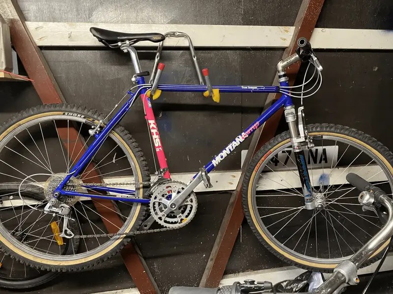

Then I built a Team style 93 Comp,
the build thread for that is here - https://www.retrobike.co.uk/threads/khs-montana-comp-build.448097/
img_7469-jpg.645129

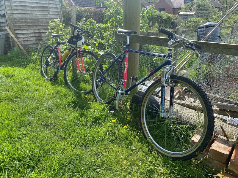

my Son outgrew his bike, so together we rebuilt the comp back to the factory original spec 93 Montana Comp LX/DX.
The Team progress wasn't lost though - a larger Comp frame turned up so I rebuilt the Team-So-Far with new cables, some XTR, some XT and Manitou 4s.

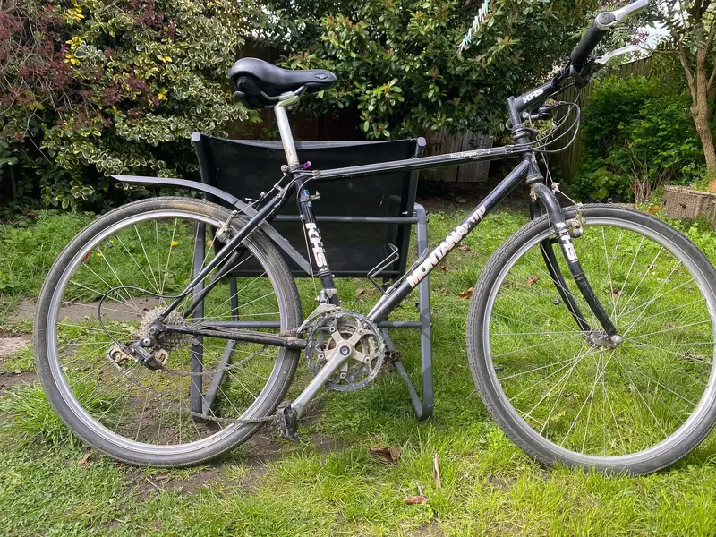

After a dramatic rescue the bike was home. I used a pressure washer on it and basically nothing happened, it was that filthy with water resistant cack!
a fair while later... a bit better..
I spent a whole day cleaning the bike, removed the mud guard, ridiculous seat, bar ends, trip computer, pump bracket, wheels off, hours of scrubbing with oil patch remover and vinegar to get the slathers of grease and dirt off the bike and actually see what sort if condition it was in!
mega gunked up!

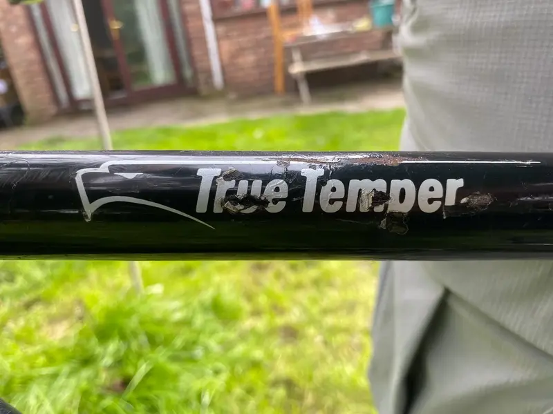

It’s got a few rusty grazes on the frame
the decals are pretty beat up

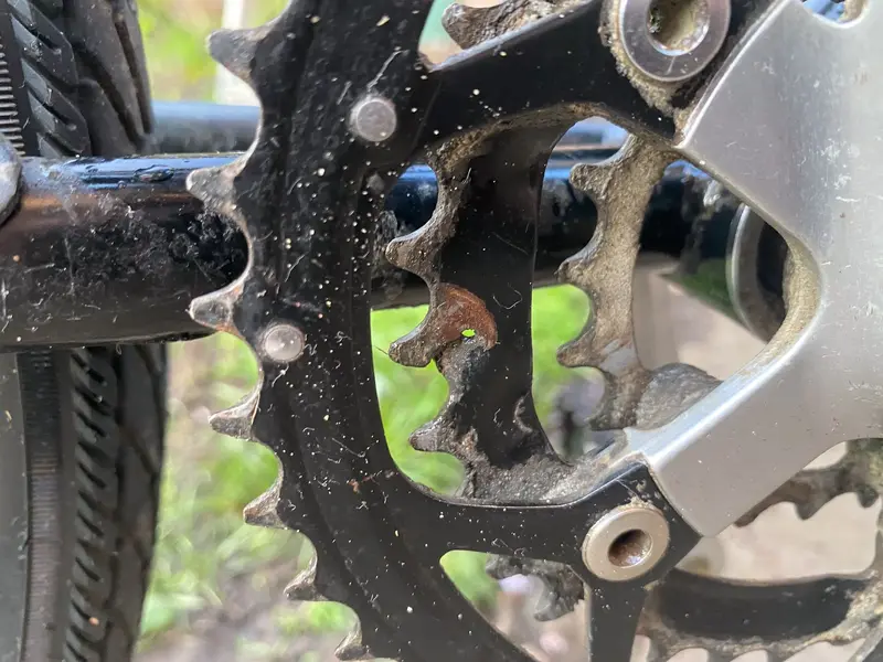

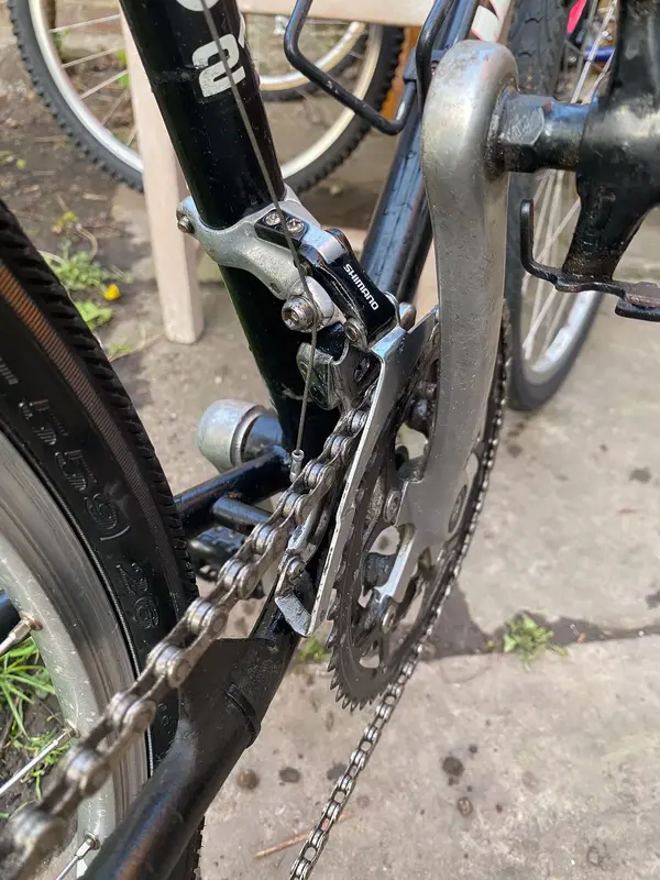

Rusty Chain rings on a Shimano Altus AT10 crank? where's the LX?!

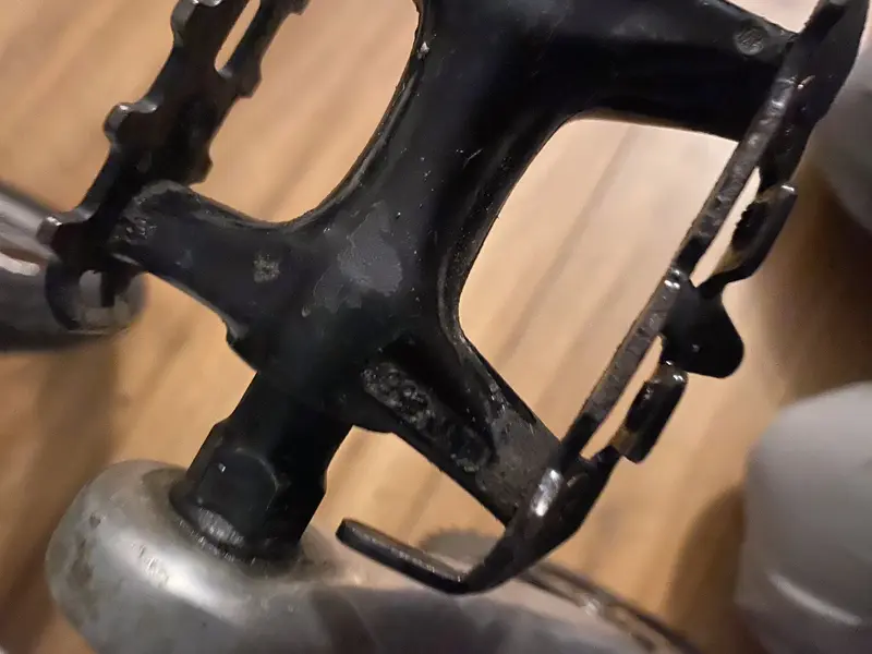

Unknown pedals

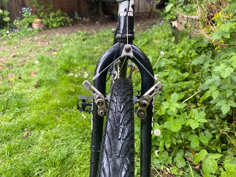

a cork shoved in the fork? is that a thing people do? had to drill it out!! IMG_0683.jpg

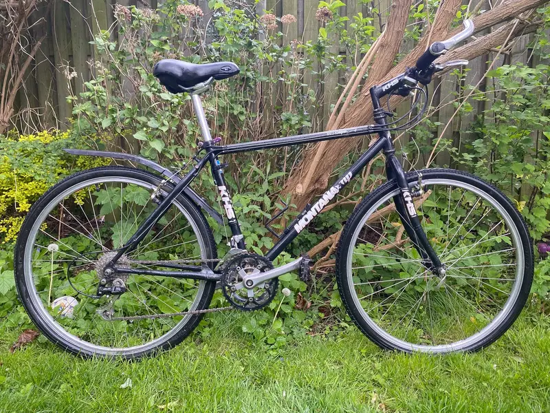

Good bits - AFTER A DAY OF CLEANING!!!!
It is the proper German Black Comp!
The seller told me they bought it from a chap in the army who was stationed between England and Germany, he bought the bike over there and brought it back with him.
Recently been serviced and re-cabled, the cables are all looking pretty good, seems someone just worked around the filth.
Now, it rides really nice and smooth.

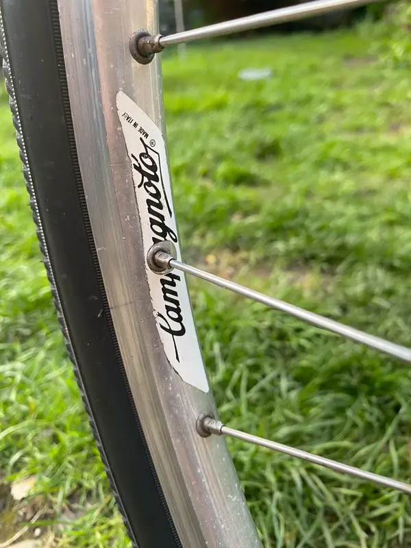

The wheels cleaned up great, nice Campagnolo rims!
Dia Compe 987 cantis and pads - very nice stopping action.

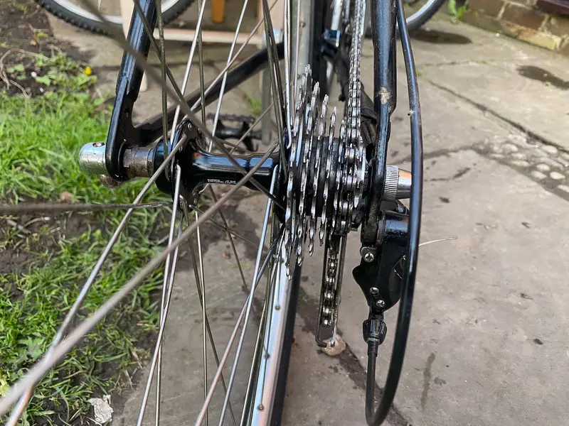

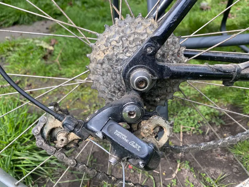

Black LX 560 hubs - again cleaned up good, spinning really nicely. LX RD-M567 Rear Deralliur - decent condition under all that gunk.

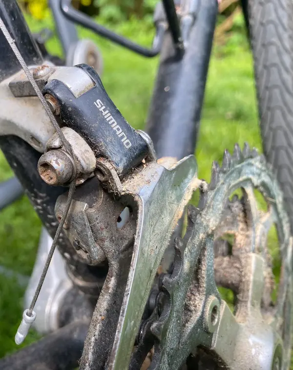

It’s got something I’ve been after for ages, a DX M561 Top Pull 28.6mm FD!

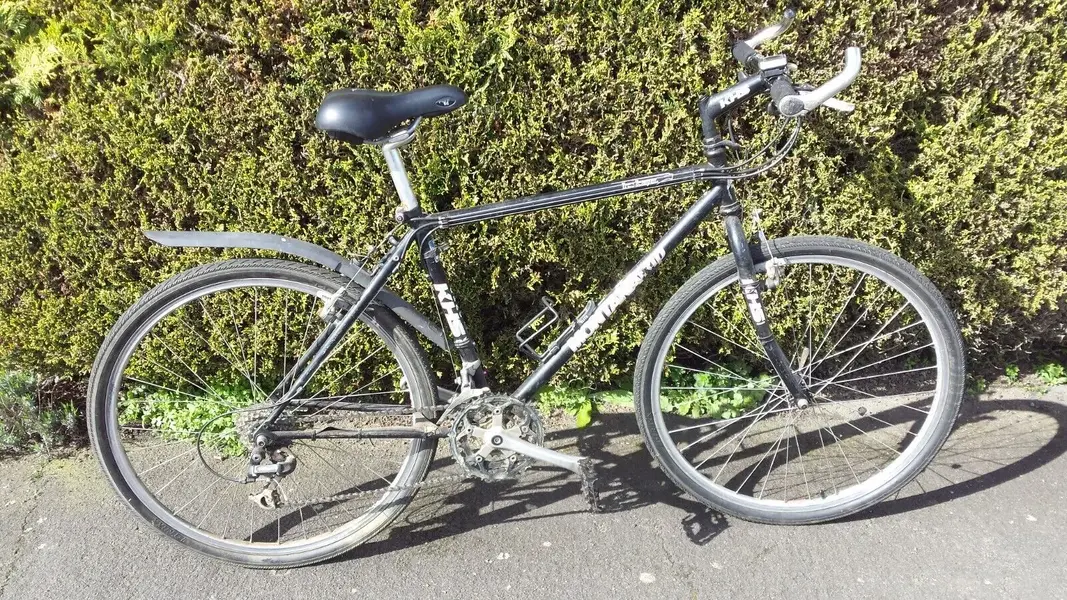

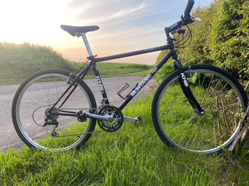

Soo. plenty to get on with, but here it is in it's current state, pretty cool!

A cork up the steerer tube was a thing in cyclocross circles back in the steel fork era to stop crowns and steerers rotting.
