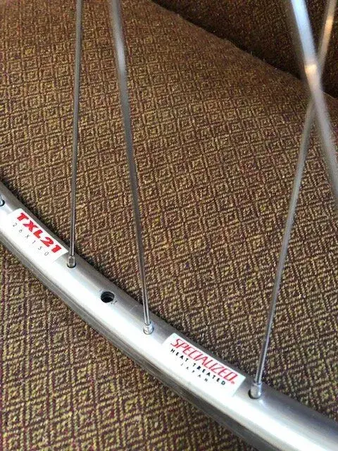

I'm awaiting another pair to come in but here is first option for a wheelset.
A lovely condition Suntour XC Pro Greasegaurd hubs on Specialized TXL21 rims, 32 hole. I believe these are the same wheels as on Ned Overends 92 M2 S-Works so a fairly decent pair of wheels.
Front weighs in at 852g and the rear 1086g (the attached cassette weighs 231g according to the Suntour catalogue). I took out the skewers before weighing.
I think thats a pretty light pair of wheels, but has anyone here got a similar year pair of wheels they can compare with these weights? What counts as light, super light, heavy etc.

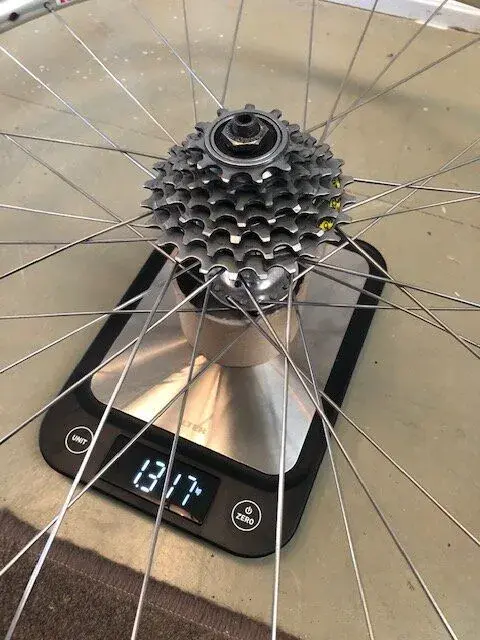

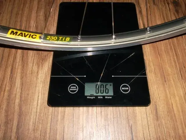

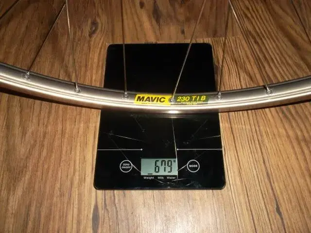

If you're happy for me to keep spamming your thread... (PM me if you want me to shut up!!)
Those aren't light weight wheels. They're good wheels, and should take a thrashing, but not light.
Rear Wheel;
Front Wheel;
Cassette;
You won't get much better with the shifters though, only Gripshift x-rays were lighter, and not by much.
Also bear in mind, my aims were a bit tighter than yours, in that I wanted front suspension too (and Maguras by the end) so that gives you a few hundred grams to play with, but that's not MUCH really...
