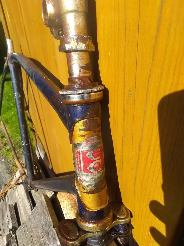

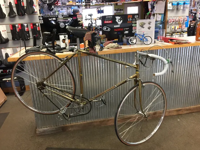

I'm not sure how good an idea this is. It's a 64 Claud Butler Olympic Path. Just want to avoid that paintjob on wheels look. I'm guessing there's a recommended way of 'not making it worse'

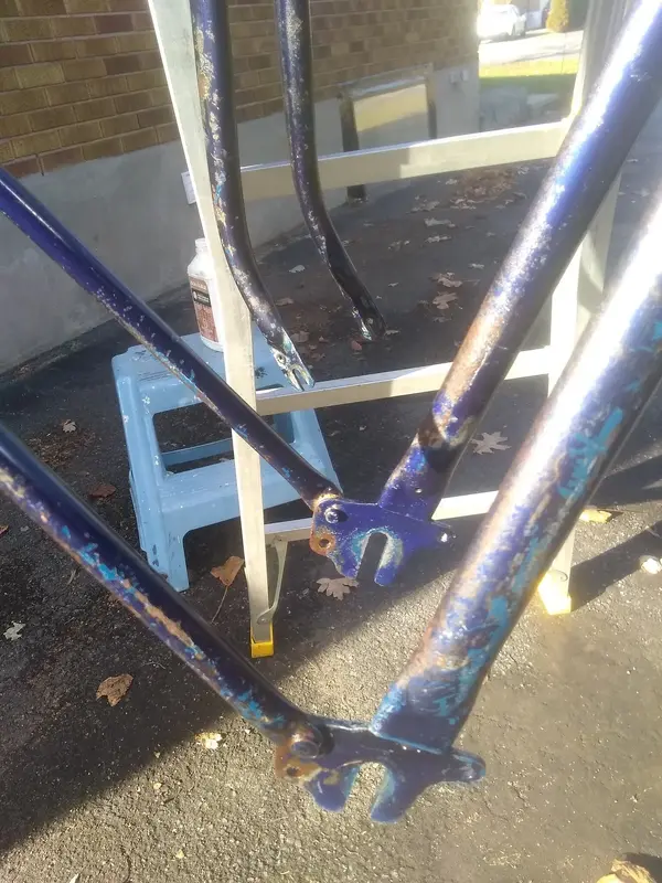

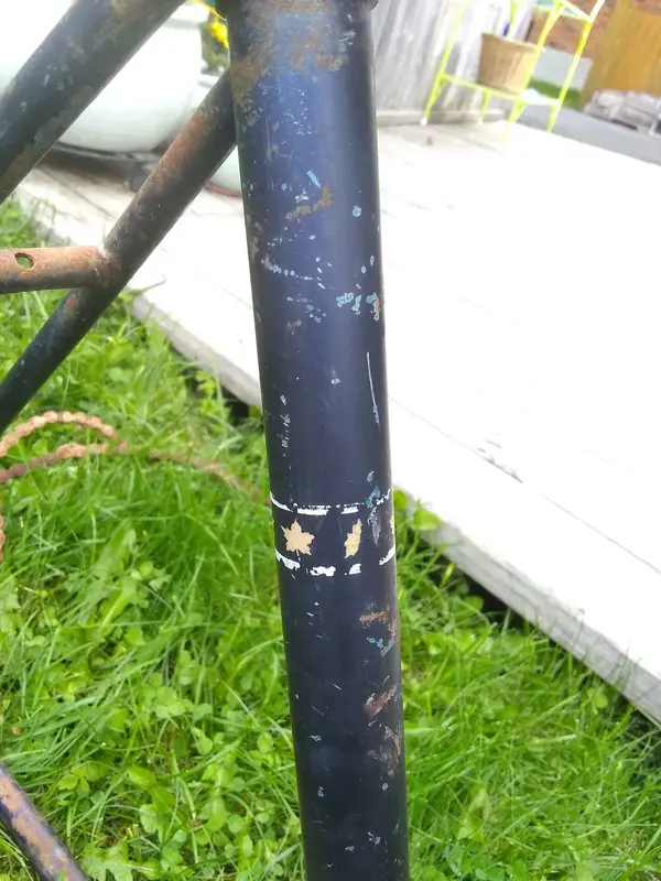

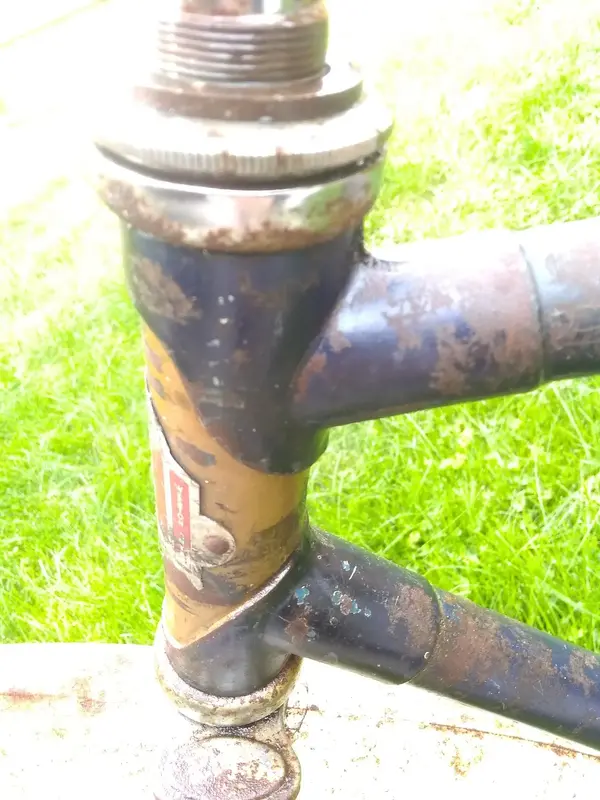

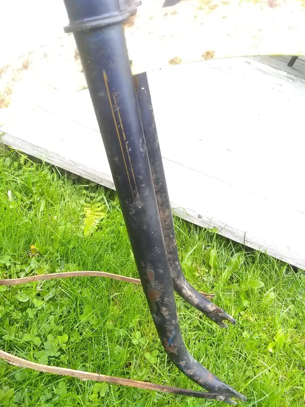

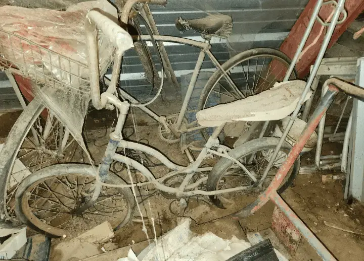

Did someone say rat? I love boiled linseed oil for preserving old patina. It's a wipe on rub off process. The oil is oxygenated, so not only does it stop rust and protect against corrosion, the oxygen actually revitalizes old paint. Here's it is in the barn where it sat for 40 years (the one in the back) 211665-Screenshot-20220922-183458.webp

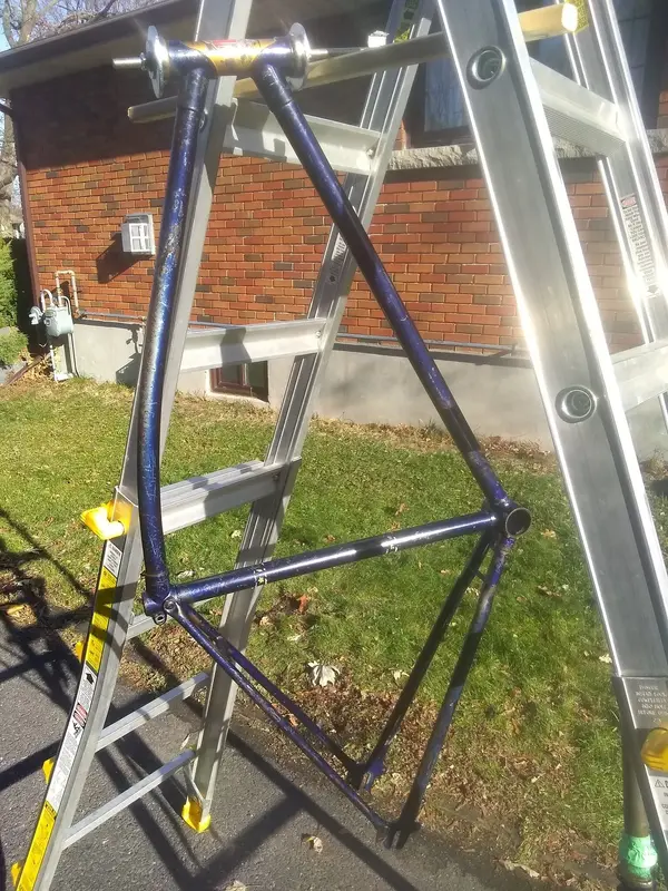

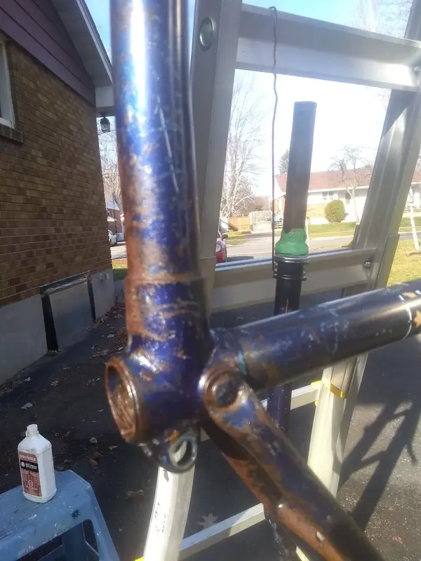

Some "before" details 211443-IMG-20221001-105015146.webp 211445-IMG-20221001-105021920.webp 211406-IMG-20220930-150730781.webp 211444-IMG-20221001-104953411.webp
And after a little cleaning, and the boiled linseed oil. This is dry, the finish gives a wet look 218385-IMG-20221126-113632029.webp 218383-IMG-20221126-113431568.webp 218381-IMG-20221126-113351651.webp 218384-IMG-20221126-113359046.webp
