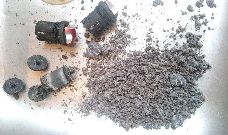

This is what came out of the forks :facepalm:
Yep, that mess is normal.
