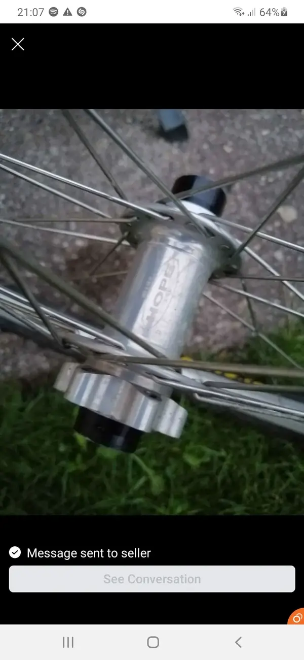

I only have the photos from the listing when I bought it. Not even sure which hub it is. Is has 02.04.Bl stamped on it.

Right that looks like a bulb so you should have 19mm/13.5mm (19mm is disc side) as you can see from the list below (provided to me by hope) there are some close sizes and it’s not a stretch of the imagination to think that you might just have a incorrect end cap? I have literally done this my self as it’s really easy with the bigun’s as the are so close in size.
20mm hope spacers measurements
Disc/Non Disc
Big un pre 05
21mm/19mm
Big Un 05-On
20mm/18mm
Bulb Splined
13.5mm/13.5mm
Bulb 6 bolt
19mm/13.5mm
Pro 2/ EVO/ Pro 4
19mm/19mm
