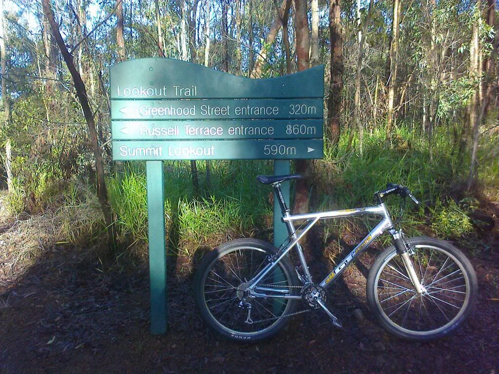

A picture from my ride this morning, perfect trail conditions after a few days rain, then some time to dry out overnight..bulk traction!
