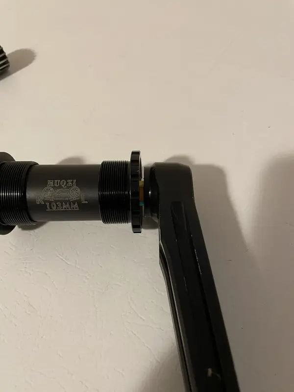

Ended up pulling the trigger and ordered a Chinese Ti unit 103mm long and it just clears everything so best chainline possible I figure using Race Face Turbines. Did notice a slight amount of play but very minor, no way to remove it with the design so I'll keep an eye on it. 159g so super light and only $65CAD.
I'll report back on quality/durability if anyone is interested

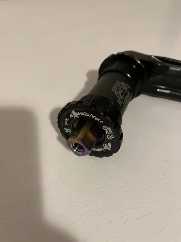

Update, I cannot recommend this BB. That is unless you are okay with spending a lot of time modifying it so it works the way it should. I have only done a couple rides on mine so can't comment on long term durability, it's held up so far, yup, very light weight.
I mentioned mine had a bit of play but minimal, I don't notice anything while riding (so far). I'm just finished a 93' M800 restoration for my 17 year nephew (he noticed my sons rigid Cannondale and realized how great bikes of this era can be). He also wanted to shave as much weight off the stock 25.5lb as I could without breaking the bank, I got it down 2lb, I purchased one of these Chinese Titanium units for his build as it is a very good gram loss vs dollars spent ratio.
This second unit I bought has a lot more play. There is no way to adjust bearing play with this design. The bottom bracket shell has to be bang on and the BB has be match exactly, bad design. I spend a fair bit of time fashioning a fender washer to fit inside the non-drive side cup to take up the slack being careful it does not introduce any drag, couldn't tighten the cup all the way down so used some blue lock tite. Not the best but should hold up (hopefully).
