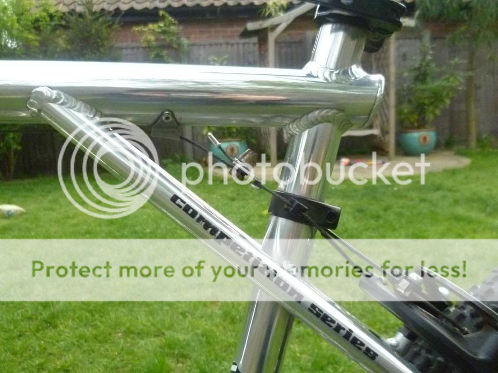

Here's whats on mine right now.......
There may have been a switch over period on decals then maybe?
All I can say is, that mine are original and I have 'Competition Series' written on mine.
I also owned a '91 Zaskar from almost new back in the day and that also said the same.
I'll see if I can find some pics, maybe someone on here can shed some light on it :)

Wow, you're right :o
Well, I see yours is March '91 and mine is May '91 so maybe mine has the newer decals? or maybe it depends on whether its a genuine UK bike or an import?
Either way, its a bit of a shit for you as it may/will be difficult to get hold of that particular decal - may have to source it in the US.
