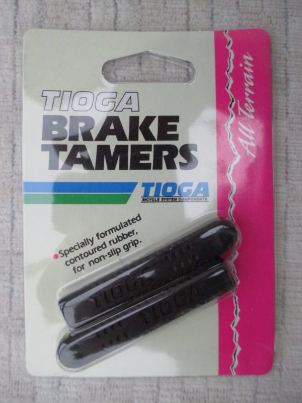

Also just bought some of these:
Got them to protect the painted XT levers mainly but also thought they'd be a cool bit of retro kit :)
