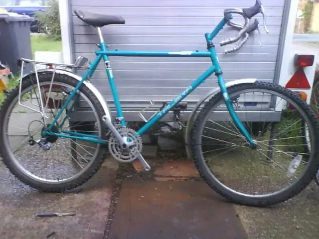

this isnt finished yet but I am going to use this to frighten Pickle & co on 30 November.
Drop bars obligatory BTW.
Lazy angles, highish front end - completely inspired by this thread and my own perverse drop bar fascination.

My first Mountain bike an FW Evans ATB ( i.e. Ritchey copy, with drops).
Photo taken Summer 1984 (near Southport).
Faster than a Cleland on-road but not off-road.

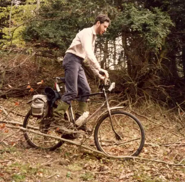

My Second Mountain Bike. (I kept this one)
1983 Cleland Aventura (Taken 8 June 1986 near Guildford).
Note the standing upright technique, ready to lift the front wheel over obstacles or holes. One flick of the pedals will create enough torque reaction to unweight or even lift the front wheel.
My favorite Cleland riding Technique is to ride standing upright on the pedals over large, low frequency, bumps. The riders body stays still due to its own inertia and the bike rotates around its bottom bracket, whilst the arms undertake a movement very similar to rowing.
Who needs suspension anyway?
BMX riders will know what I mean.
