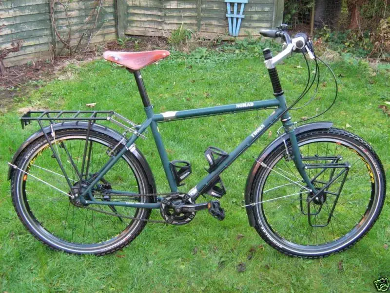

I may be way off the mark but noticed this on Ebay today and how similar it seemed in principle...
1979 and all that . . .
Similar in appearance, but not in principle.
Look at the long rear end, and the forward slung handlebar. Those two factors neutralise the weight bias, as described in one of my earlier posts.
Mudguards have very little clearance and are fitted with stays, bad news off-road where twigs and sticks can catch up in them, and they do!
Other non-Cleland factors are:
lowish (by Cleland standards) bottom bracket and ground clearance
rim brakes
lack of a guard between the tyre and chain
MTB size 522 wheels.
Nice bike, but it doesn't fit the Cleland mould.
