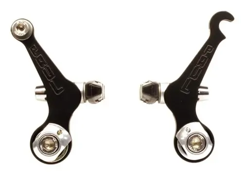

IYO - what are THE best Cantis?
Froglegs!
http://cyclocrossworld.stores.yahoo.net ... rosbr.html

Wide frogleg old style canti's are the best. I set one of my mtb's with them, they were as powerful as Vees, just a bit of a pain to set up.

Low profile canti's are a compromise, get some wide oldschool type :wink:
