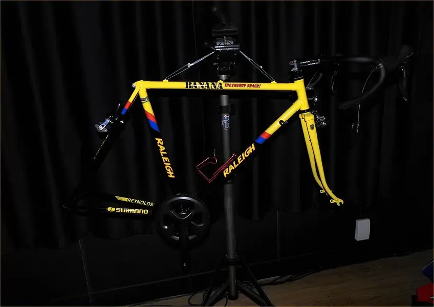

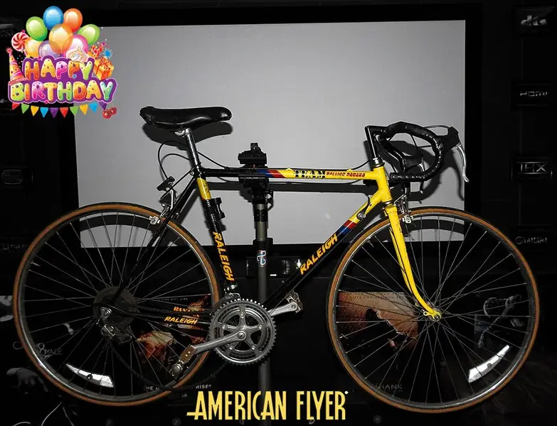

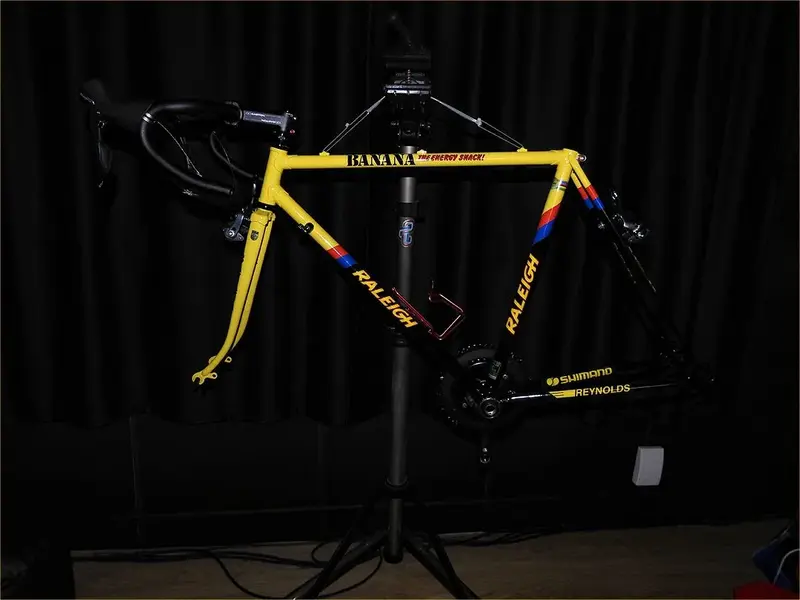

Thought I would post a couple of images of where I am at with the Banana so far, without your guys advice I would still be stuck on just a bare frame :lol:
Before: (was a birthday treat to myself) :oops:
After: (I got my grubby hands on it) :lol:

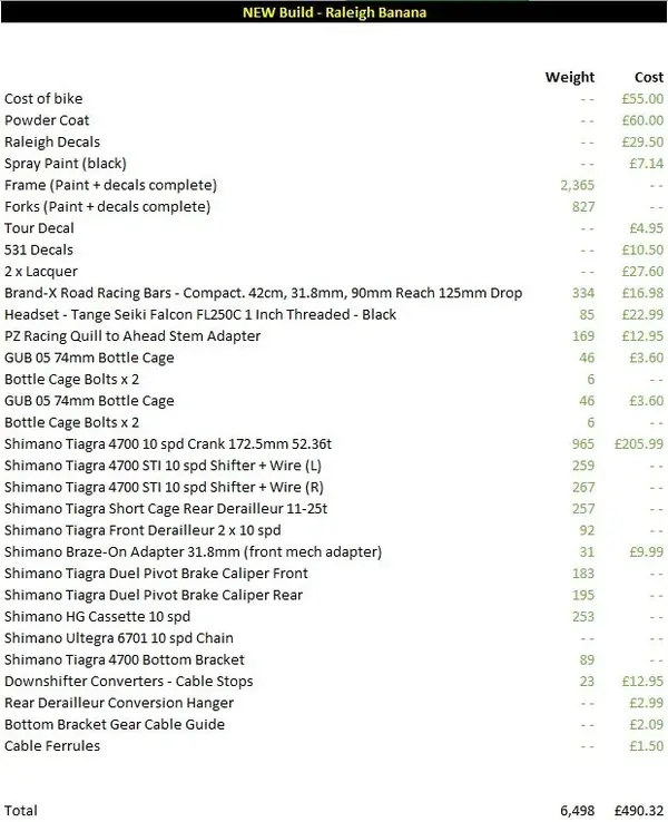

Figured I would weight all components, ideally I would like a 10kg Nana and if I don't make that I can look down my list and see where I can save weight and go from there. This gearing is gonna be hard enough, I don't want to make life any harder by turning a blind eye to the weight of the iron horse :lol:

Check the inner chain ring isn't steel. Easy weight savings there by swapping to alloy.
Likewise plenty to save on the seatpost. Light aluminium ones weigh the same as most carbon.
