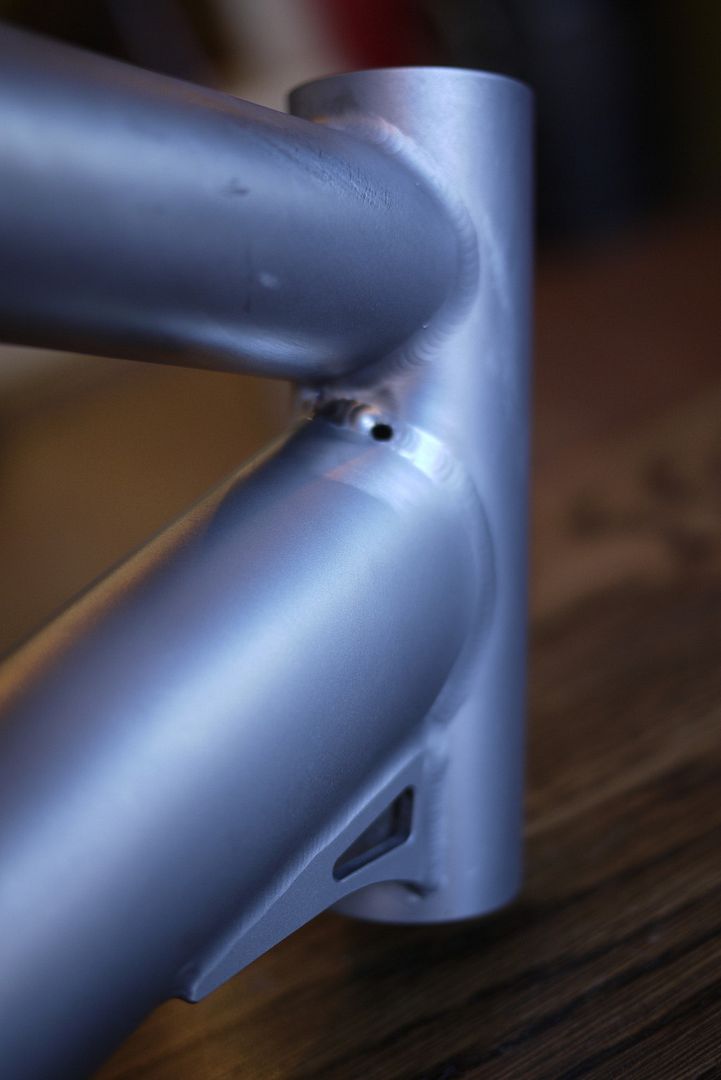

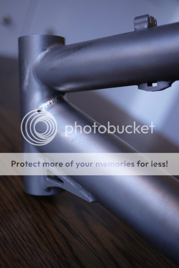

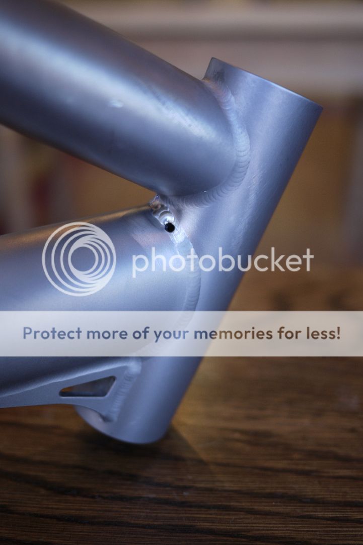

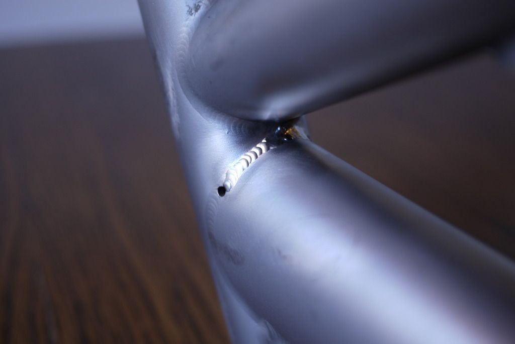

Mmm...I don't think I am very happy
The weld has been drill stopped at each end of the crack, followed by quite a neat weld...it certainly isn't a bubble gum weld. But shouldn't they have filled the drill holes?
What are your thoughts?
And part of the quote including cleaning the frame...which has not been done.
Once I clean it and apply new decals it will look nice again though. I guess this should be my project although I was looking for a fancy steel frame
