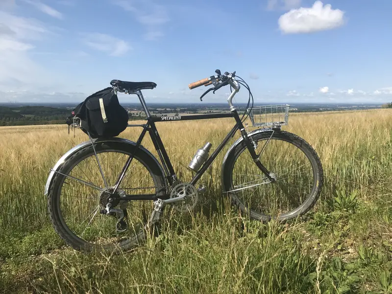

Yes, you can adapt a stretched out MTB with higher front and more forgiving bars. And if you are fond of a bike you’ve owned forever, it’s fun to persevere with. I went full dork with my Specialized below, but you can fine tune for what you need.
Things to think about:
Higher rise shorter reach stem - like a dirt drop.
Bars that curve back: try starting with North Road bars - they are cheap and have lots of curve and sweep, you can also invert them like moustache bars - and when you know what you want, there are loads of tastier options for your final build.
Trial and error is key, so maybe start with a cheap stem with a face plate that allows you to try different bars without loads of fuss - and lock on grips that can easily be removed.
Oh, and when you move the weight off the wrists, it goes backwards, so think about saddles too.
