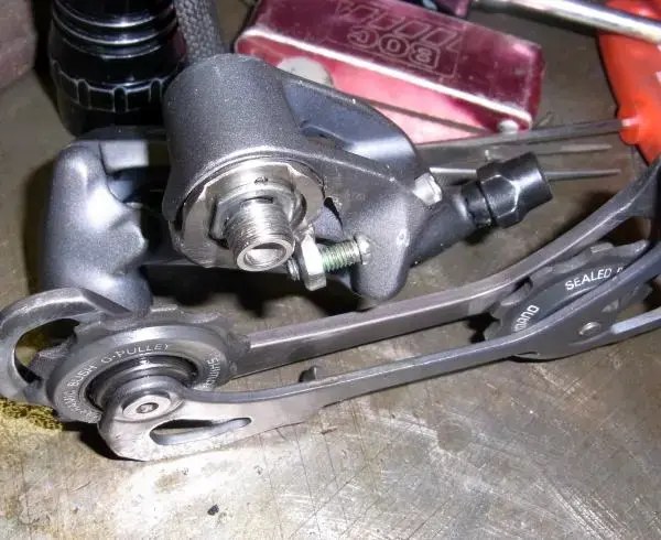

Got my rear mech yesterday, Gave it a bit of a clean in petrol/diesel, it didn't come out very clean; should I mail the bloke and moan about that the fact the tension jokey wheel is almost round, or accept if I will buy cheap parts I will get shite;-) I bought a broken ultrasonic cleaner from ebay almost a year ago[bought as broken and very cheap] and haven't got round to trying to fix it, but I bought the components I thought it needed last November[not that I really have a clue about electronics]. I replaced the parts this afternoon, took about 5 minutes, I switched it on and it buzzed away;-)
I stuck the still dirty rear mech in and after 5 minutes the inside bit's, bit's you can't get a brush at, were all clean! Doesn't look it in the picture but it really is clean.

If sold as jockey wheels ok then mail seller. Replacement jockey wheels are about a tenner making mechs like yours worth peanuts.
Looks clean in the pic!

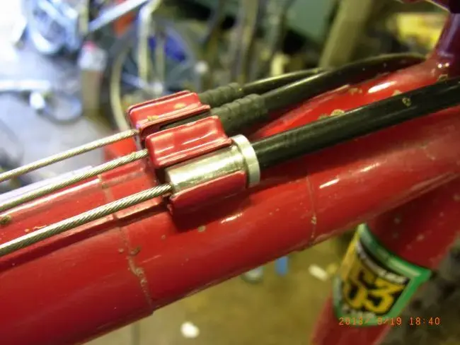

I put the cables on. I hadn't put them on as I needed to make little top hat cable ends to to go in the hose clips on the top tube. Worked nicely and the cables sit square unlike the cables with nylon ends in the proper cables stops, apart from the cable ends I made as I ran out of bought ones.

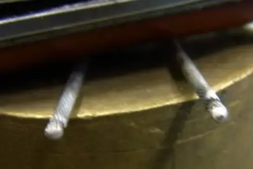

I welded the ends of the cables, I had been meaning to try welding them and never got round to it, very easy and hopefully no fraying; I put heat shrink tubing on as I usually do.

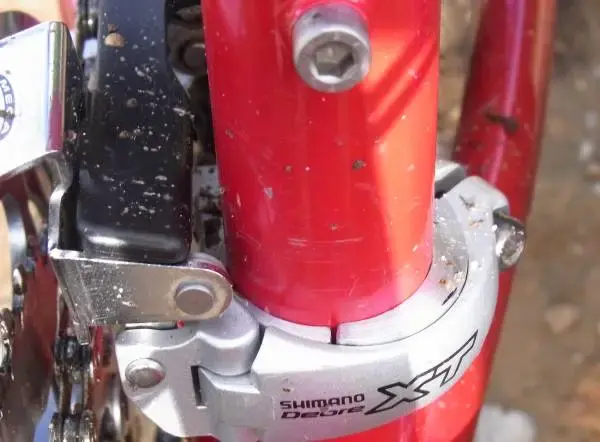

I changed the bottom swing xt front mech for a top swing, the cable angle from the stop was terrible with a bottom swing mech. All the front mechs I bought for it, I have bought three now, were 34.9mm, so needed shimming. I made a concentric shim and when I came to set the mech up found it wouldn't go back far enough, a shim with 1.5mm of eccentricity cured that.

The rear brake cable stop. The frame has stops/clips for brake hose, so I used these little ali cable ends.
The ends of the cables, tigged so I can rem derailleur or a shifter and the cable won't fray. Very easy to do[if you have a tig;-)] hold the tungsten real close to the end of the cable and a quick dab on the pedal and it's done.

The eccentric mech shim, with a concentric shim there wasn't enough adjustment to get the cage back far enough. I can't remember if I checked the chain line.

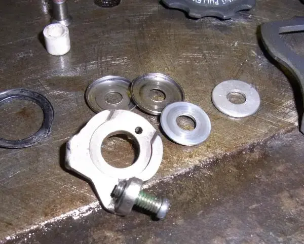

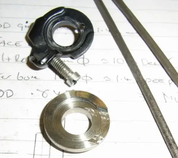

Last time I rode it I caught the mech on a log, bent the hanger a little and broke the B adjustment plate. I have just made a new B adjustment plate. Not ridden it yet as I got some XT disc wheels a few weeks ago and need to make some brake adapters for the calipers now. I suppose I should have looked to see how much a new B adjustment plate would cost;-) Anyway it's now got a stainless one, I guess the aluminium one breaks before anything else.
