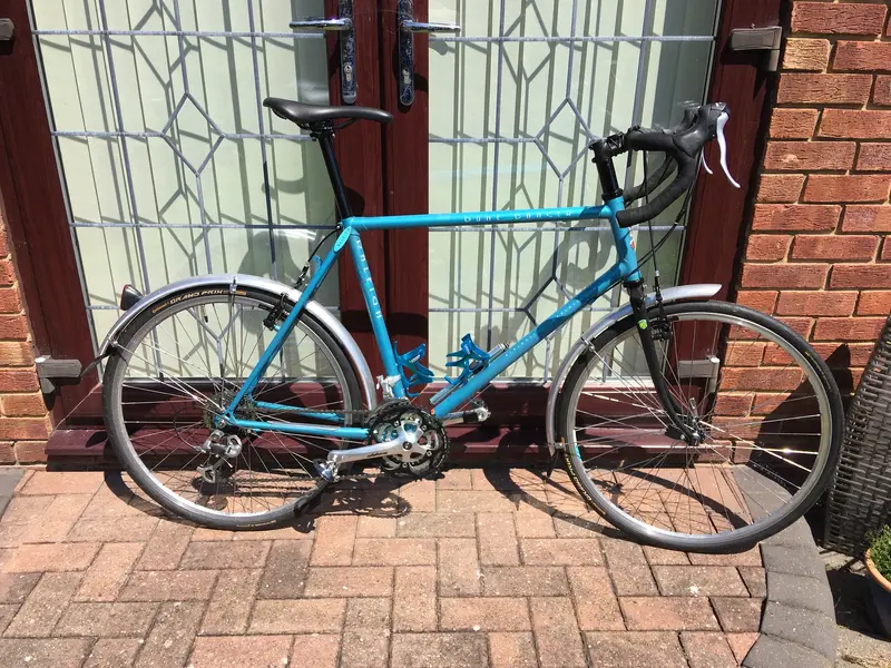

Ive also measured the stack and reach of the frame with the help of a laser level....strange how these figures never made the specs bitd. Now, its all anybody seems interested in.
Well....its pretty short for a XL bike, with a long reach for drops.
Reach 440
Stack 580

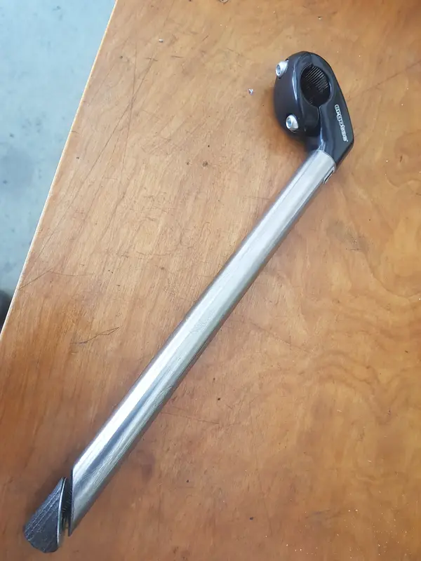

Working from a fairlight faran (which i sat on a mates the other day) which has a 650 stack and 410 reach, im going to need a pretty short stem....may be 50mm tops. Im also going to need the stem to be minimum 150mm above the current headset, just to be level with the saddle...let alone higher! Blast my lanky parents!

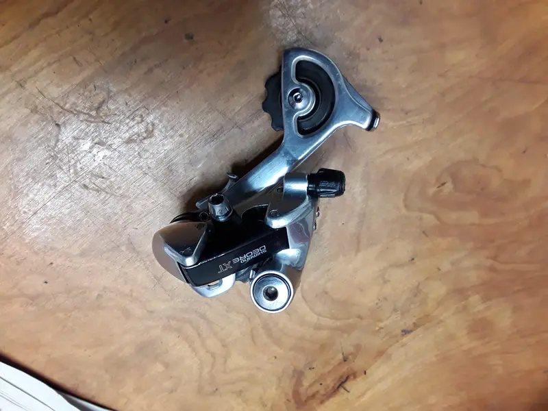

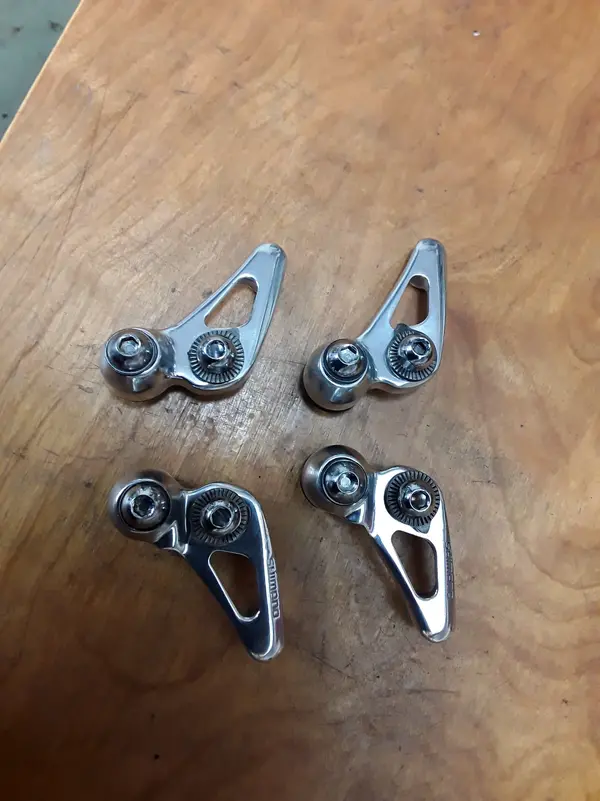

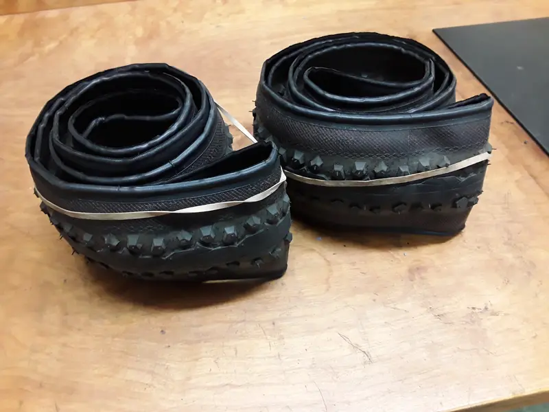

In the meantime I've fished out some cantilevers, rear mech, tyres and blocks from the stash.

Sadly the bars won't go through a closed face stem. Seems to be an issue with compact flared bars....but then they were never designed to need to!
You could always opt for an open faced 1 1/8 threadless stem with a quill adapter, it will give you many more options.
