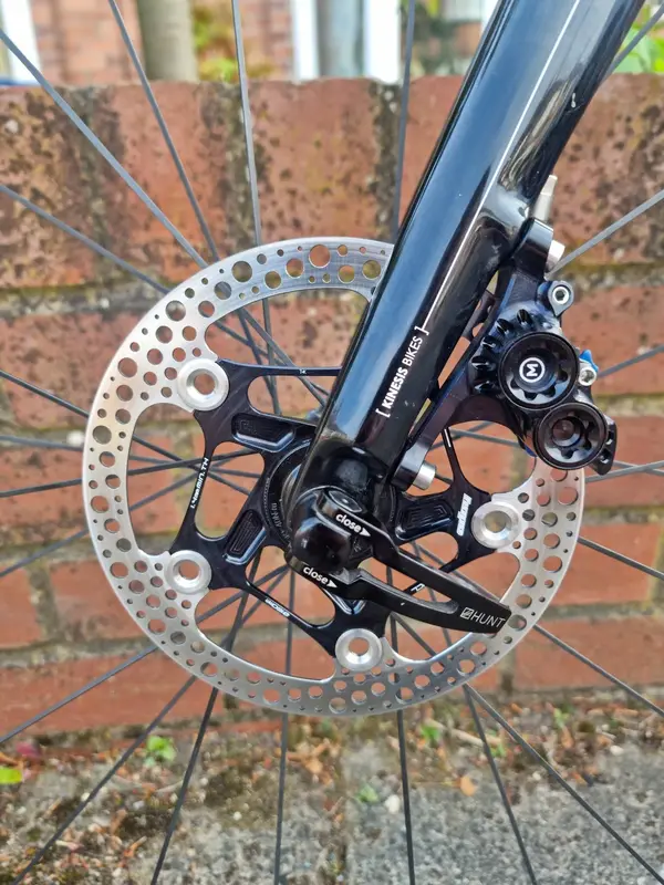

RX4+ calipers arrived. Very nicely as usual from Hope
Took the opportunity to strip and clean it a bit. New chain , cables etc.
Calipers on , not bad to bleed really by following the video. Makes a mess though which I’m glad im not using DOT.
Not sure the Rotors I have are a good match as they are Brake track is slightly too narrow for the pad. I’ll see how it goes tomorrow maybe on a ride.

The first pair of RX4+ had a leak from the pistons so we’re replaced by sjs. The second pair are fitted and work really well. Far better than the grx and look nice too. Only done about 1k miles on them but no issues so far.

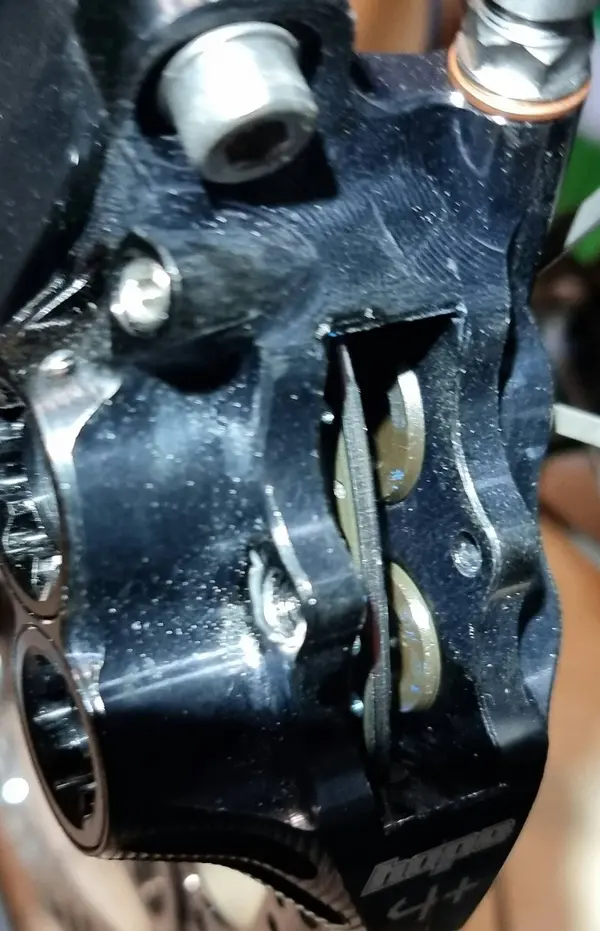

I fitted the calliper and rotor today and bleeding the system was pretty trouble free following the Hope videos. Loads of power, easily able to put the bike onto the front wheel with two fingers on the hoods. Skip ahead two hours and I decided to ride the bike to the pub, screaming brakes.. I pulled the pads out and they're covered in oil coming out from the pistons, all four of them by the looks of it. Do you think it could just be factory lube on the pistons and not a leak? Im going to pump the pistons in and out and clean with isopropyl a few times to see what happens. I don't really want to have to remove the calliper and go through the warranty process..

This is exactly what happened to my first pair.
They screamed so bad and had fluid all over the pads. I tried Cleaning them up but same happened again. The shop said they had never had any issues but I found posts on forums saying otherwise.
My second pair have been perfect though.
