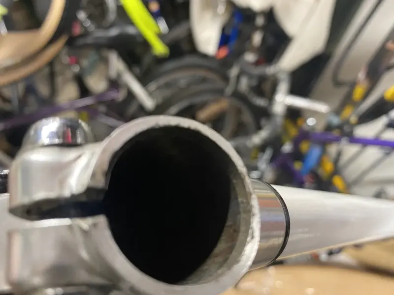

Is this a shim or meant to be there?
Gtpulse
Dyna-Tech Fan

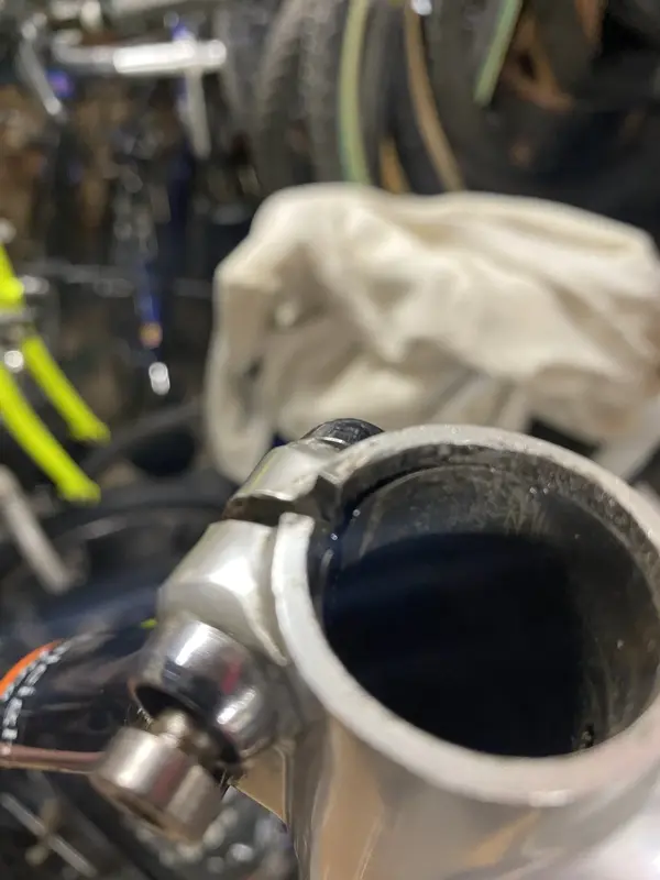

Dyna-Tech Pro frame arrived today, giving it a once over I noticed the part in the photo. I think it is supposed to be there but thought I’d ask in case anyone has seen similar (or not!). If it is a shim it’s been cut perfectly to the slot in the top of the tube and also has a hole where the top tube joins which makes me think it is there by design.
4B113533-8637-49F3-98CA-69BF5F225014.webp 59817182-6A86-427E-81A0-045078EAC094.webp 4D43887C-F839-4A5A-B55B-34E8293817CE.webp
Never had a dynatech...these are bonded? If so that's the main seat tube!
I think Mickeyspinn you are correct! I can’t see nor feel the end of this if it were a shim, when I shine a torch down its continuous. It’s 2080 tubing which according to the inter web is Reynolds 753 and probably very thin. Never imagined a tube could be as thin as that but appears that’s what it is. It’s really strong, I touched it to see if it would peel like a coke can shim - in hindsight I shouldn’t have done that but luckily it really is strong or I think I’d have creased it. Looking at the slit perfectly cut in it I think it’s probably meant to be like that so it moves with the clamp?

Reckon so! Surprised the tube doesn't sit onto a shoulder in the lug but i guess it doesn't really need to !

My DynaTech TourLite also looks like that except the seat tube finishes level with the top of the seat lug (not slightly short). I too thought it was a shim at first.
