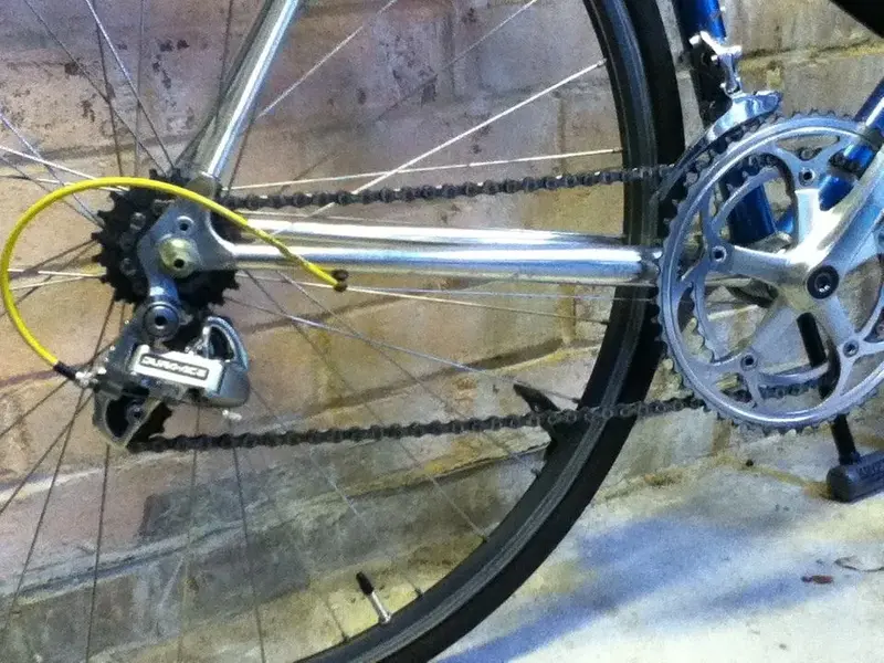

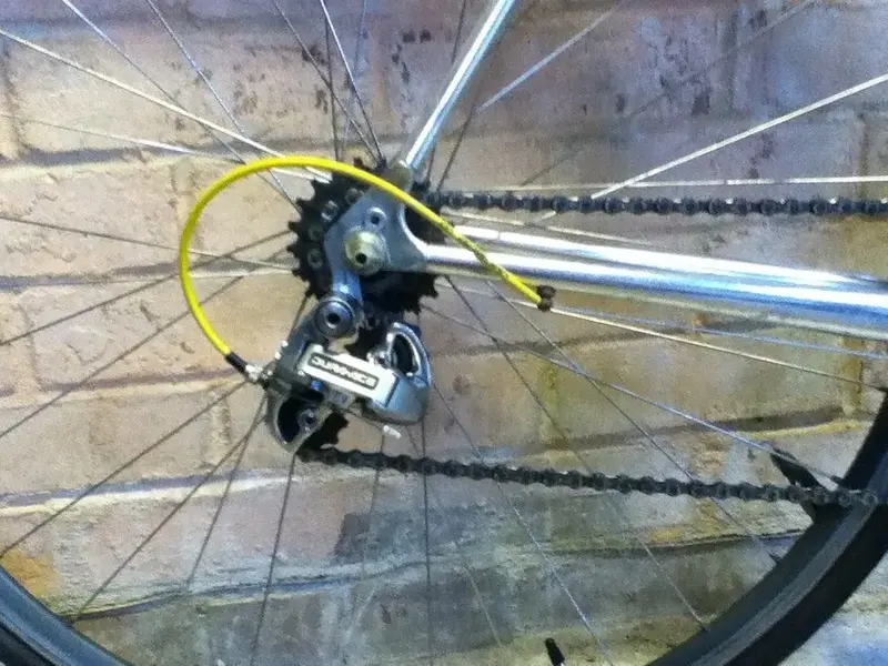

Pics as requested of little to little:
For what it's worth, it looks like you should add an extra pair of links to that chain. With the increased length it will still enable you to select small/small without the chain fouling on the forward (top) derailleur sprocket.
Whilst the big/big setup you've currently got seems to work, you're running at the limits of the derailleur's travel which may increase wear and decrease reliability.
Your bike though!
