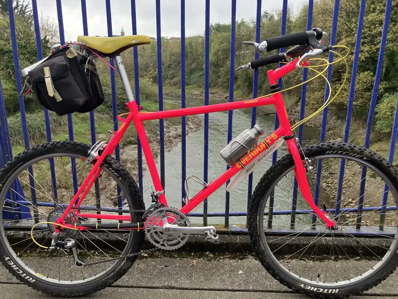

imho the later overburys pioneer with sloping top tube looks all wrong with drops, you would be better off adding drops to earlier peak finder/cross fell which were modelled on Moots Mountaineer of 1982-83 and look ostensibly like a swollen touring bike.
On a pioneer you could try some modern flared bars like Sonder Bomber which are a good half way house between flat bars and drops and also have a wider range of positions to rest your paws on / mount your brakes and shifters -
pioneers have very high (feels like it to me) bottom brackets so you end up perched higher, leaning further forward over the bars
