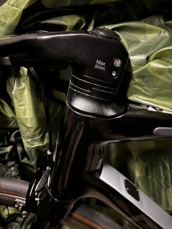

Thanks for reply. It’s a 2022 Ribble SLR . Picture attached, but I know what you mean. It is that top shaped spacer that is throwing me as is so flush with the bar. However I could use any normal round spacer to get the tension. Might not be as aesthetically pleasing as now but I need wider bars.

You'll probably need to find a stem system from a brand who makes a compatible top cover for your frame. It might just be easier to buy the same again from Ribble, so you can use the same spacers etc.
Otherwise, Acros and Deda both make headsets for internal cable routing that just let the cables pop out of a hole at the front, then you can just use conventional round spacers, stems and bars.

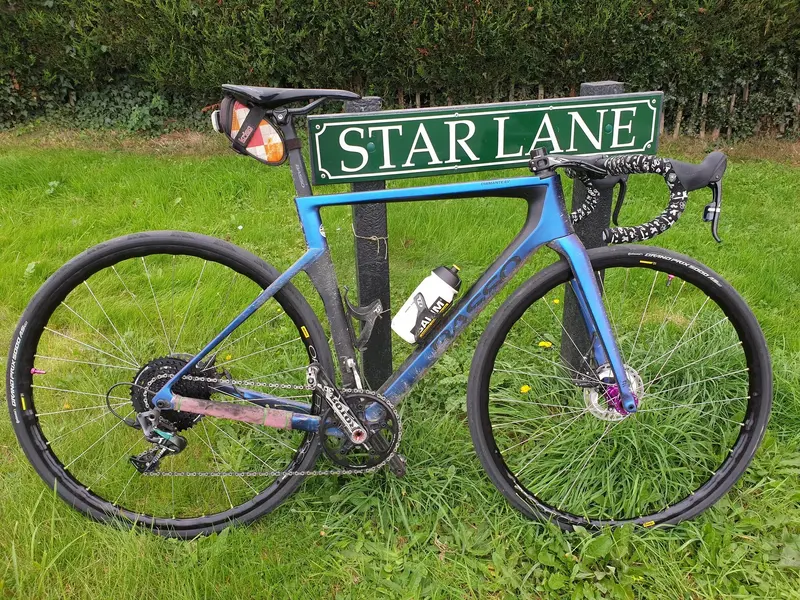

I didn't like the integrated bar that came with my basso so i removed it and replaced it with my favourite easton one. I just bought an acros top cap with holes in and rubber grommets to channel the cables into the head tube. Cost about £12 and works a treat.
I bloody hate internal cables, but i do love this bike.

assuming a standard spacer will fit I see no reason not to print up a surround to it. Whilst I'm not as posh as you guys with this style of intergration I did print a 5mm surround so I could slam the stem on my bike, glued to the normal aluminium spacer it works nicely.
