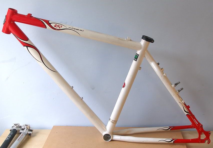

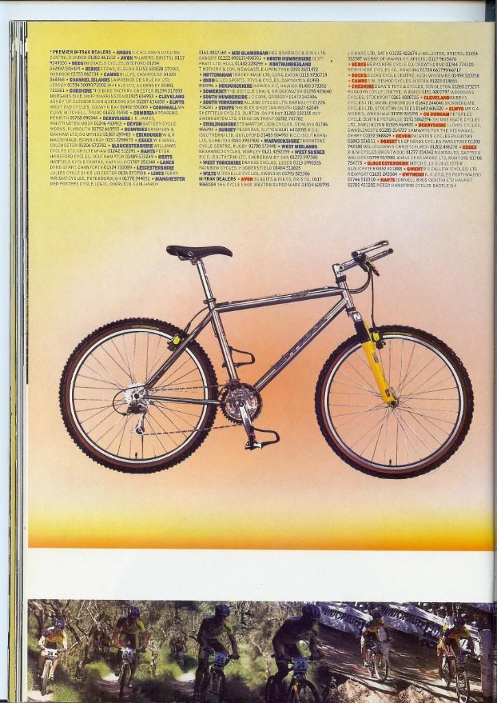

Right I've found some pics in MBUK.
Basically my frame is the same as the one Barry Clarke used with the same team decals.
I can't find any adds for this as a team bike, just the standard bike.
Here they are calling it an M-Trax 450 elite titanium.
Chris.
