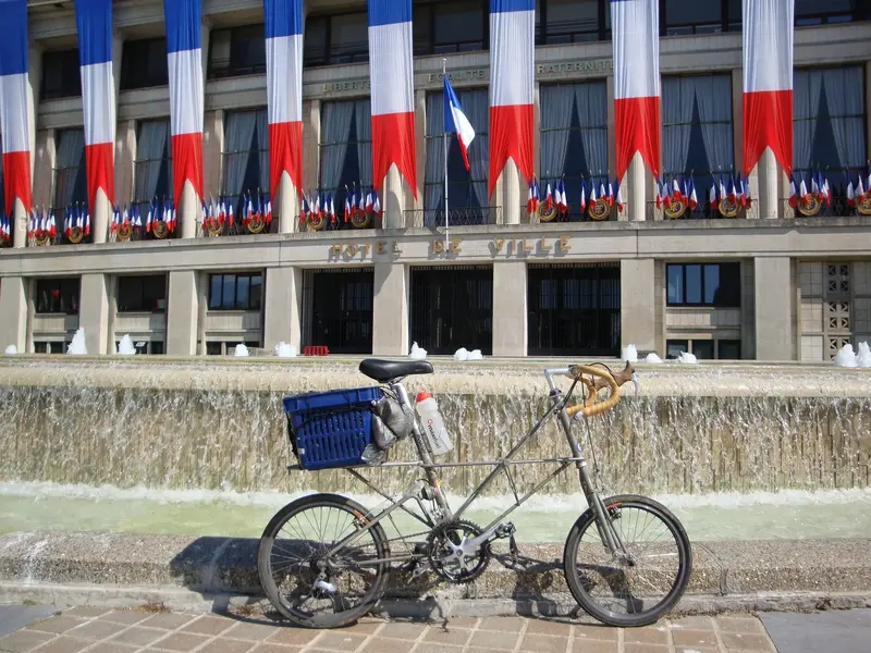

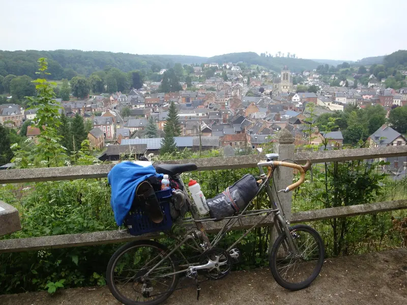

Probably one of the greatest bicycle designers of our time and often overlooked was Dr Alex Moulton. The space frame Moulton is the stiffest steel frame out there that defys logic with it's small diameter tube triangulated construction with virtually no flex at the bottom bracket when force is applied to the cranks. I proved this on my first Space Frame Moulton by destroying two chainsets in the first three weeks of ownership..
They are wonderful bikes - and held the land speed record, I seem to remember.

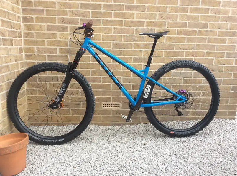

I’m not going to forgo this 29er ‘double diamond throwback’ when I’m hucking jumps though…,
