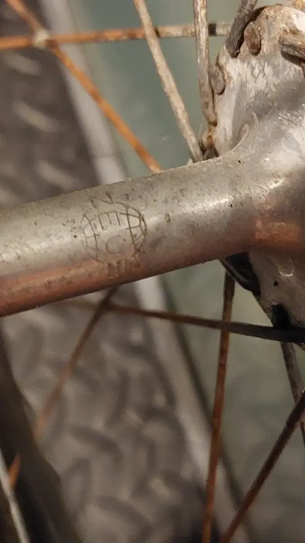

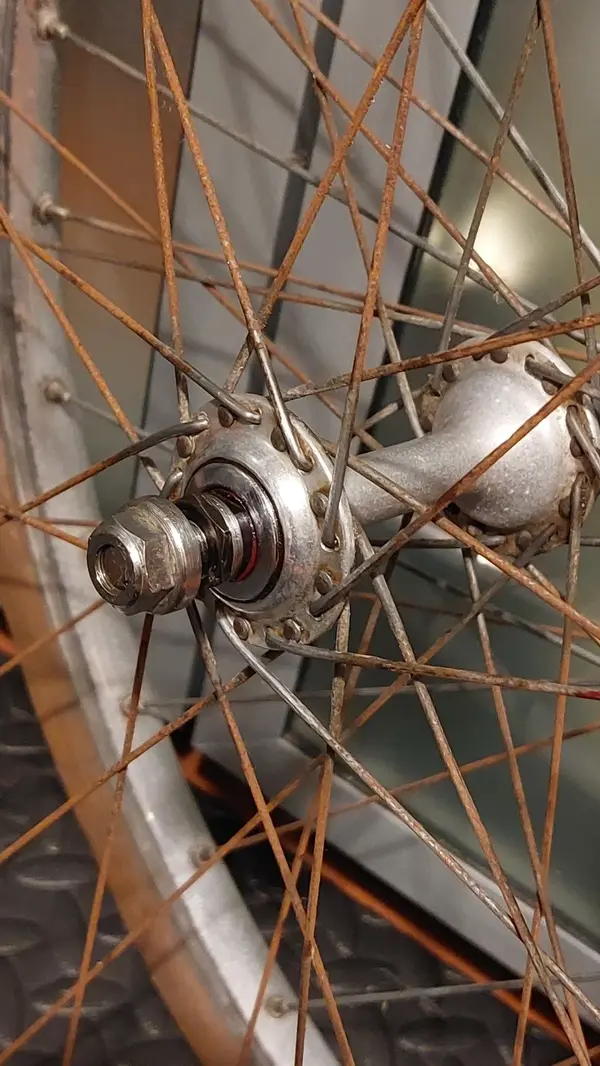

1. Zeus low flange solid axle hubs (marked BSC, i.e. British thread freewheel). They look like Zeus Gran Sport to me, but with solid axels, which I can confirm have Zeus stamped on. 100/120mm OLN - could they be an early version of Gran Sport or perhaps any other model?

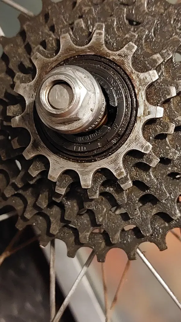

2. Suntour Winner Ultra 6 freewheel - came on the ^ wheelset - what toll is needed to remove the lock ring before removing freewheel itself. Once I do ,I'll know if thread on the hub is for fixed or geared/ss freewheel

the Zeus world logo visible on the hub barrel goes back to at least the 1960's
about 1971-72 this logo changed to the Zeus oval

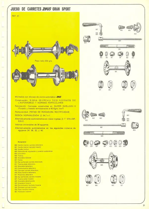

hubs could have been part of the Gran Sport ensemble was well as the Criterium, very good quality with nicely rectified races
world logo may well go back prior to the 1960's, do not know a launch date for it
Thank you - the bike is from 1954, perhaps these wheels came in 1970s, i somewhat doubt they are original as rims are 700c and not 27" as would perhaps be a norm in England in that era.
They are indeed good quality and spin very nicely. I just never seen low flange 100mm front/120mm rear with solid axle. Need to take that freewheel off to check what threading it is.

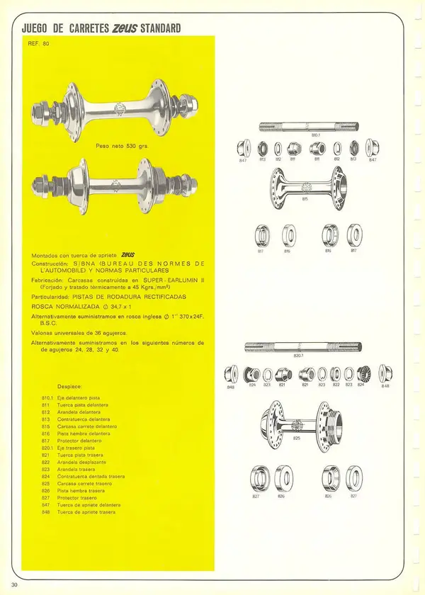

Fabulous , many thanks for the catalogue pages, solved the mystery, again Mr @juvela So judging by the parts, they seem to be 'Standard' type, although from what I can see, there are no differences in construction, material or weight.
suspect drawing of track model rear hub may be a cheat as it shows only one threaded plateau; note also how coarse threads appear, drawn in not to scale
on a track hub one would expect to see one thread for cog and a second for lockring
Need to take the rear wheel to LBS - could not take the freewheel off myself - then I'll be able to report back what thread is on 😀
Few days of penetrating oil and long spanner turned out to be a winning solution to get the old freewheels off. Standard freewheel thread it is 😀
