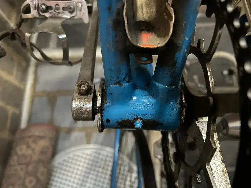

I’ve spent a lot of time on classic Viking cycles. It’s the serial number on the dropout that has me confused but apparently these serial numbers were quite haphazard before 1954. Once I start disassembly I will look for the frame number on the steerer tube. He was so adamant it was a Tour of Britain and that he purchased it in Feb 1952. He has written about the bike in some regional cycling publications and always described it as such.

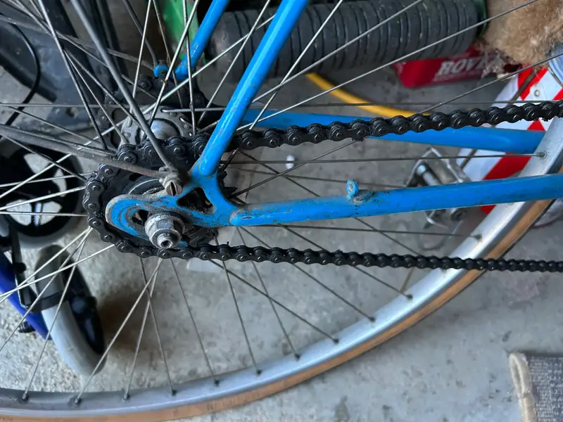

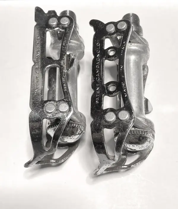

pedals -
cycle's present pedal set something other than Campag
note how cage attaches to body with rectangular tabs whilst Campag employs round
note how barrels be three-piece steel whilst Campg are forged alloy
the deeply counterbored medial spindle ends are a positive sign of quality
readers should be able to identify subject pedals with further image(s)

the machine's present Chater Lea chainwheel appears to have 3/32" dentition which would be compatible with a derailleur drive train
