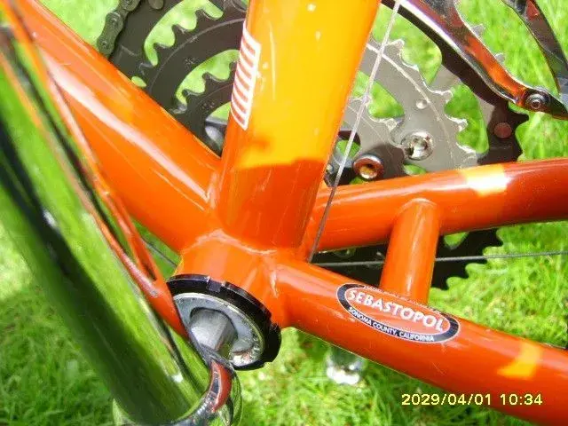

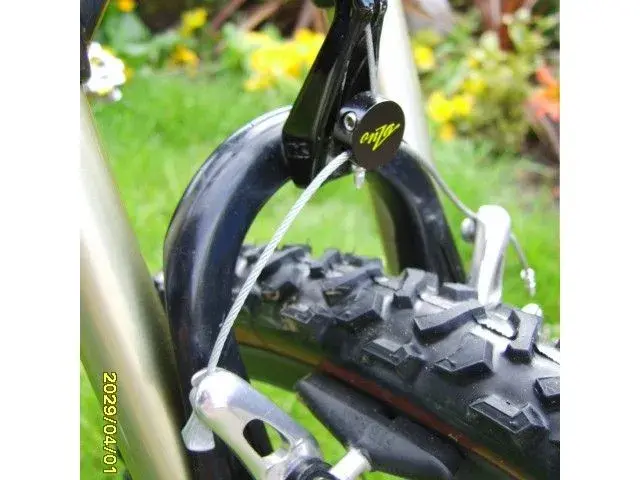

aaaahhh... xtr. we are getting close.
may i suggest something? drop the travel on that sid. from 80mm to 63mm..
the mojo you have is designed for 63mm.
ride it and tell us about it. 8)
I have tried it with some judys, 63mm :roll: and I much prefer it the way it is.. no more forks , no more changing groupsets, just little fine tuning now.. it rides spot on, happy with it as is :) :)
Oh! and according to the IBIS catalogs it is designed for an 80mm fork.. :)
Hi Sithlord,
Very nice 'finished' result you got there
How did you connect the cable holder to the the fork brace?

The XC pro stuff is heavier than the XTR stuff by quite a bit overall, bar the front mech, and to be honest I think the XC Pro front mech is nicer looking and changes much cleaner than the XTR one.. IMO.. the forks are a set of Sid SLs which have a brace , that allowed me to mount a 'kona' hanger for the brakes , so problem solved..
I was initially going to use a newer set of Sids for the bike, with a 'lock out' lever mounted to the bars but decided that the older ones with the 'lock out' switch mounted on the legs would look cleaner and offer a small weight advantage too... :wink: , I think it worked quite well.
