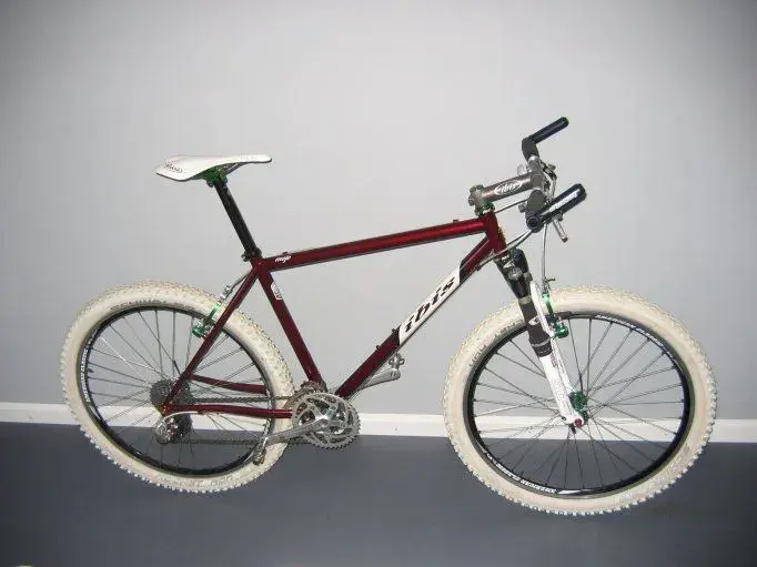

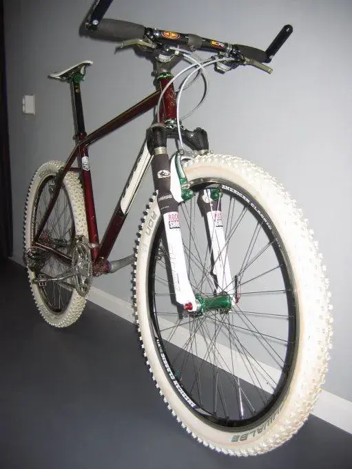

some updates of the 2001 in it's latest trim... with the limited edition Rocket Ron's and the green Hershey's on it... 8)

Spec's as it is now.
The CK-wheelset are gonna be replaced by Tune/NoTubes by the time my rear hub is replaced for a new one, since it cracked and is send to Tune.
Frame: Ibis Mojo 2001 (Deda tubes)
Fork: Rock Shox custom (SID Race titanium with a BB crown and head tube)
Headset: Chris King ahaed 1 1/8”
Stem: Ibis titanium 1 1/8” x 125
Handlebar: Easton EC70
Grips: ?? ...just 22 grams or so..
Barends: Extralite
Brakes: Hershey Long neck
Brake levers: Extralite
Shifters: SRAM X.0 triggers
Front Derailleur: XTR
Rear Derailleur: X.0 short version
Derailleur/brake lines: Jagwire L3
Cassette: SRAM 990
Chain: SRAM 991
Cranks: good old Ritchey compact
Chainrings: LM 44T, TA 34T, TA 22T
Bottom Bracket: BICI titanium
Pedals: Crank Brothers with steel axle
Hub Skewers: Tune AC16/17
Hubs: Chris King classic in green (from the '95 Ibis)
Rims: American Classic 350
Spokes: DT evolution
Tyres: Schwalbe Rocket Ron 2.25 in white limited edition
Saddle: Selle Italia SLR
Seatpost: Ringlé Moby
Bottle Cage: Ringle H2O
Standing on a person scale it, the scale says it weighs in at 9,5kg or just under 21lbs.
With the Tune hubs and NoTubes rims it wil be 20.5lbs. And sometimes I'm thinking about the Pace C-type that's collecting dust in my shed to put in and bring it under 20... 8)
I'm a bit in doubt about this one..
To sell or not to sell ? That's the question...
I'm thinking about selling the frame to get myself a modern frame, but don't know what this one will be worth... anybody any idea ?
Or...maybe it's an option to get it converted to discbrakes..? What do you think ?
