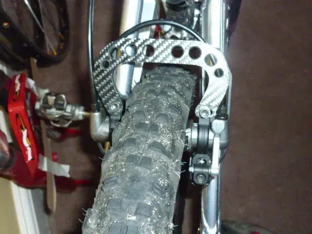

You can if you need to just unscrew the bolt that holds it to the quick release side of the brake and take it off then replace the bolt,best to use them though.....mind you the old manitou bikes did not have them fitted so ...........
The mounts on the top of my magura are 80mm apart,where the booster fits.
the actual brake mounting bolts are also 80mm.....

Thankyou,I was thinking of buying some carbon sheet and making one myself :? cant be that hard :oops:
Cutting or sanding carbon is rather dangerous,well the dust is :lol: .I'd recommend you invest in a decent mask.

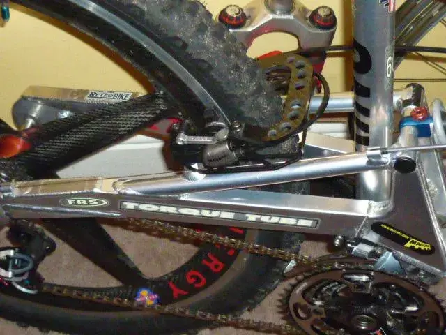

A fellow retrobiker,who shall remain nameless,helped me out by making this lovely carbon booster for me,it arrived just before my enforced holiday so I have not been able to report back but it fits perfectly looks cool and does the job nicely 8) 8)
Thanks my retrobiking friend.........
MM
