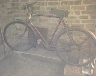

I have found my dad's old road bike circa 1959.
He's had a traumatic year and I would love to restore it and make him smile. He saved it all these years for sentimental reasons so I know my heart is ruling my head but can anyone help or offer advice please?

Pictures not great but I always think that as long as the frame is solid, there's not much that can't be fixed/replaced.
What are you thinking of doing to it?
Is it a Raleigh Trent Tourist? Hard to see from the picture.
I did a 1958 Lenton Sports for my wife recently. Stripped, cleaned and polished then put back together. Which I think is the way to go with these fairly low value bikes. You could end up spending hundreds to do a full resto which will also remove all the patina.

Good luck! a lovely thing to do!! dismantle....clean thoroughly every part. WD40 or white vinegar with crumpled up tin foil to lightly scrub away any rust patches. replace anything that does not work (ebay or this forum). if you want to replace any decals go to H Lloyd. A nice new brooks saddle and new bar tape, chain and tyres will make the bike look brand new again. common household kitchen degreasers and polishes will help.rebuild!
