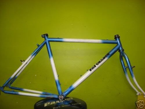

Its perfect for what I'm looking for. Its beat to hell, and needs a lot of TLC. I got it on the cheap, I think, and I'm pretty excited. Its going to take awhile though.

Yes, I did notice it. It is indeed a great project for you Amey. A bit rusty here and there, but of course such won't be a serious problem for someone with obviously 2 right hands. I hope inside is a bit clean/free of rust though.
The fork doesn't look like a great match too me. It may very well be a great fork, but it is brazed. And FAT is about synonym for welding.

First off, what size seatpost?
Second, I've been reading around to determine whether it's a wicked or a regular Fat, I need to check the head/seat tube angles. Was it the wicked with the steep 69 degree head tube, or the other way around? :?:
I'm skeptical about the BB collars. The seller says they're intact, but I have my doubts (from the pics). Other than fatcogs, is Ebay my best bet?

after stripping and beadblasting, take a good look at the seattube. There are two holes drilled through from a stuck seatpost that causes two issues; one, there may be more structural damage to the seatube from the traumatic seatpost removal, two...open holes subject these frames to rusty interior states. The whole seat tube may need to be replaced. Not hard, but a bit time consuming.
As for the bb collars, I have NOS ones in black or silver I can set you up with.
