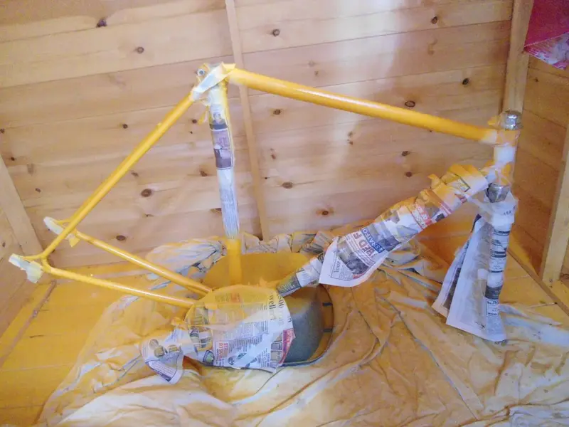

pics of paint progress attached :)
Easier to paint rear triangle rather than numerous touch ins, and usual marks on TT from cable clamps to sort.

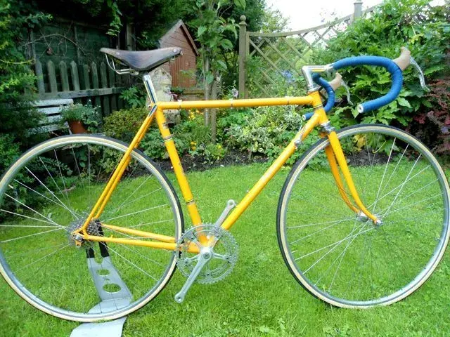

more pics
here's the finished frame awaiting new decals; the Cinelli giro bars fitted to 1A stem and campy SR post have been re-panto'd and cloth Tressostar tape fitted with original screw type bar plugs. The brake levers are Record, drilled.
Hubs are Record with Nisi rims and new conti tubs.
lovely brooks saddle proofrided and buffed

Reminds me of my youth :) very nice. Be careful tightening the front mech, quite a few of us cut the middle out and quite a few of us snapped them :(
Will your rear mech take the large cog on the block?
Cheers
Shaun
Cheers
Shaun
hi Shaun, yes those shifters look a bit risky for everyday use, if I keep her I'll probably fit a pair of Simplex retrofriction I have ( sold my spare Campy set :( ) freewheel is a Shim 14-28, I have a few choices in my spares, Oro 13-21, Atom 12-19 (bit too close) and Dura Ace 12-21. i may cough up for a NOS Oro 13-26 which would be perfect but v expensive if you can find one, usually £40 or so.

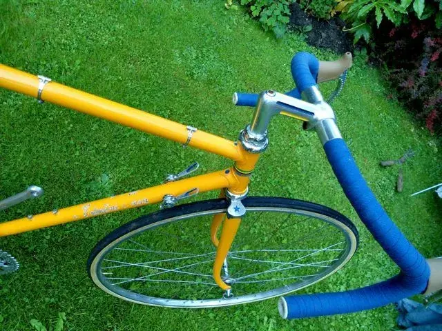

bikenut2010":37t3b521 said:
Can anyone here make these? The headtube is probably a tough call and the existing decals are not too bad, but the RH DT script is pretty crumbled ( LH pic shown as this is best shot )
grateful for any help on this one... :)
