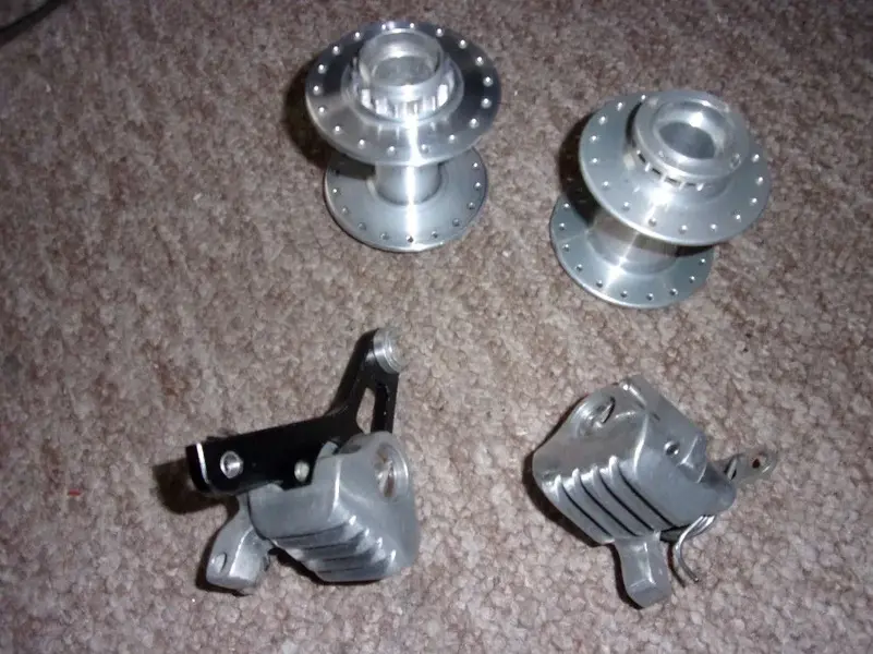

I think ive your entire set up here.
Hubs are new though ive no internals, basically as im not sure which axle fits. Might have a 2nd lockring and ive a spare mono freehub for this set. Axles/spacers- Hopefully the other like Boxxer/Dave will have more idea :?
But i think thats all the important bits. Those rotors are the first floating rotors and unlike those today, actually do 'float'. One of the spiders and rotor, as well as the hubs is nos.

Found the other lockring. Just really thee axles/spacers to identify, and if anyone has an idea there, please dont keep it to yourself 8).

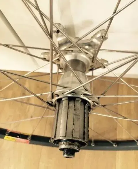

I've seen some wheels on eBay with 5-bolt spiders on the hubs, are these a later design?
I'll try and post a pic but my phone won't let me
I see the ones you mean Jim. Those would be fine.

Adds- Found the other lockring for the hubs :D and ive a freehub for it too. Its all correct, its all period together and the hubs are new, along with the correct sizes or rotors.
Maybe a joint effort on info from boxxer and TK on axles.Ive not seen these before so dont know. I might actually have them, but until i see an example i cant say.
Ill put the rear together in a couple of combos in the meantime and see if anything strikes as being correct.
I may have spare front an rear axles dyna, i need to check through my bags.....
Def have a 120 rear axle and a couple of fronts

This is what I was looking at... I assume the spiders can simply be swapped over? (I've messaged the seller to ask this).
Looks like more modern rims, I could live with that for a while. They didn't sell and have been relisted, the BIN is rather steep for me, will just see how things go I guess.

Yes, a simple swop over on the spiders. Though from the looks of things its been relisted a few times. Im not sure if hes finishing it early :? due to lack of bids.
