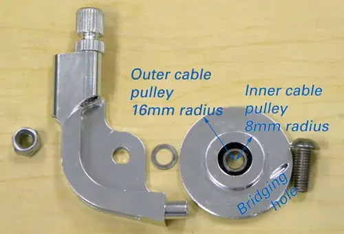

We need to increase the pull from 2x20 (assumed - the double lever is advertised as being for cantilever, and the OP is applying it that way) to a single 40mm v- brake pull to satisfy @Imlach 's "fixing cantilevers for ever"
Op already has double cable pull lever, and the bmx splitter used as a coupler would pull the same length in and out.
I think we might need a 3d printed leverage device?
2 in to 1 then a travel agent?
Dont we need to think more laterally here.
Why not twin v brakes pulled on a cantilever lever. Yes, close to the rim...but more squish for your buck.
Isn't the travel agent supposed to be long to short pull?
I don't know, I never liked rim brakes. :)
fairly sure it was for V brakes, so it being long to short pull would be a bit weird. the picture about would pull on the shorter radius pulley making it short movement to long movement.
Travel agent increases the cable pull from canti- brake levers to v-brake arms.
