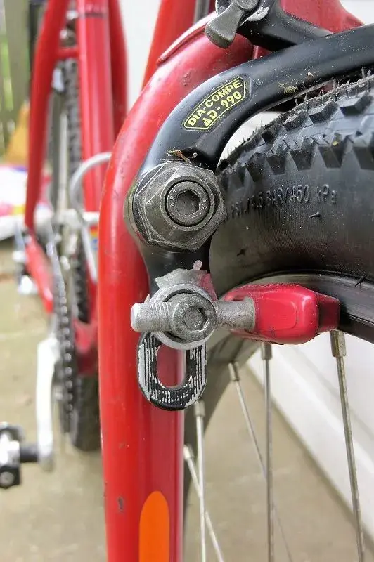

I needed more bar height to make the dirt drop work, and extending the stem more was a no-go. Cannondale made 26" front/24" rear wheeled bikes earlier in the 80s, so I figured a 27.5/26 combo would be a nice homage, and suit my purposes. This is a proof-of-concept first build, I'll be updating the bike...hopefully soon.
I swapped a fork from a completely destroyed '87 Cannondale that came up on local craigslist, which has roller cam/U brake mounts. A Suntour hubbed, Araya RM-20 (green label) 650b wheelset came up on ebay a couple years ago, I bought it for reasons I could not explain at the time! The AD-990 U-brake was on the rear, so I moved it to the front, then drilled new holes and re-shaped the caliper bodies so the pads and adjuster assembly could be moved up for proper wheel contact. I put a Suntour XC roller cam on the back, also common on Cannondale during the 80s'.
I didn't want to spring big $ for 27.5 tires that might not fit, so ebay provided cheapie (9$ shipped) Goodyears, and with fingers crossed I mounted them and...they fit!
The bike rides great, and it actually stops well in the front. I was worried, there isn't much leverage with such a short arm from the pivot. It's as least as good as the previous 'Force 40' cantilever and straddle setup that's on the '88.

You were in the ballpark, so to speak. I'm not completely convinced the fork on there isn't bent back toward the down tube slightly. I was so focused on getting the whole thing to work correctly I never really checked the fork, and the donor bike was in rough shape, left outside for years. I have to pull it all apart again anyway, I'll get a good look then.
