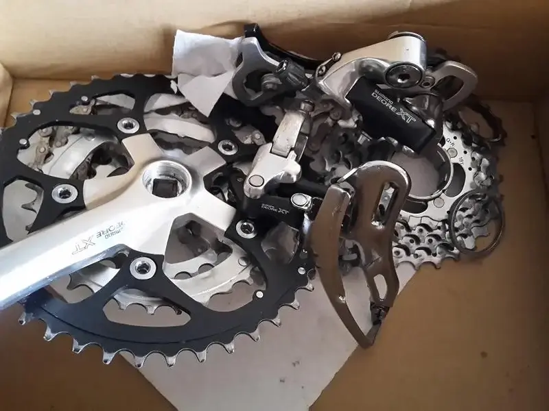

These parts have cleaned up really well. Soapy water on the big bits, FS-1 on the greasy bits and fresh lube in all the moving bits when putting things back together again. Since that bit went well I'm now looking at keeping the XT theme going if I can.
Which brings me on to the wheels. Next job is to strip the hubs down and see how they look on the inside. Assuming all is well I will keep the mis-matched wheels for now, but I think long term I will try to get a matching pair of hubs, either hope or XT not decided yet, and matching rims to, erm, match. If anyone has parts for swapsies then let me know.
