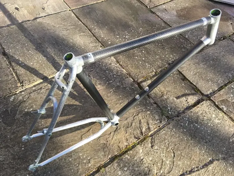

After a lot of soaking with stripper the metal work is pretty much devoid of paint now I’ve no idea what they used in the factory but that yellow took a lot of work to shift it, I’m now ready to give the bear metal a good going over with 600 grit Wet and Dry to get rid of any corrosion and equally important key the surface ready for etch primer
So here she is in all her naked glory - devoid of anything Neon or remotely shinny

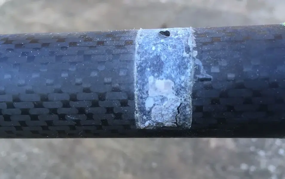

As you can see the last job was to drill out the rivet holding cable stops in place, which frightened the hell out of me and perhaps a job done first rather than last given how much time I’ve invested so far
The rot or corrosion between the frame and the cable stops was incredible proper thick which crusty chalk with a gentle pick some of it came away like a scab leaving a deep crevasse behind at this point my arse was twitching like a badgers nose - Thankfully the corrosion was sat on the clear coat that I wasn’t able to get to first time around and it was that that had come away,
Given the clear coat had been out of Ultraviolet sun light all of its life it was well and truly adhered to the frame and these two patches of lacquer took longer to remove than most of the frame did. As you won’t see this area when the stops are back on I didn’t dare clean pick too hard for fear of damaging the frame and I’ve read somewhere never to use Paint stripper as it damages the resin in the carbon so its now clean smooth and as darn close to being perfect as I can/dare get it.
front one..
and after I picked at the loose scab this appeared :shock:

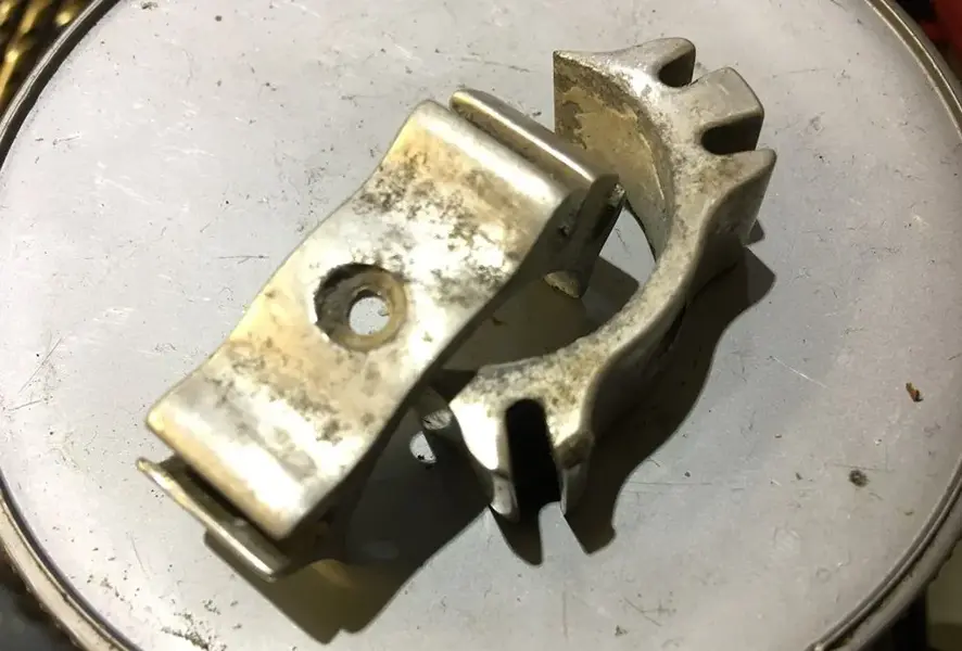

The remains of the rivet was pushed in and removed from the top tube for safe storage - so it can be measured later to ensure I buy/use the correct size
and heres the state of the stops with all the crust on them
looks like the corrosion has gotten under the anodising in various places so this could be a challenge - but I like challenges ! - otherwise I'd go to Evan and buy some homogenised modern tat

The prep work is slow going and tedious- however since it will costs the same amount of bucks $ to paint itbadly as it will to do it properly, I thought I’d invest the time. ($ just for THM and Peachy)
The white corrosion/ fluffy shite makes one hell of a mess and it’s surprising how black dust sanded Aluminium makes on your hands/work area
Hopeful this weekend will see the arrival of tack rags and a good solvent clean
