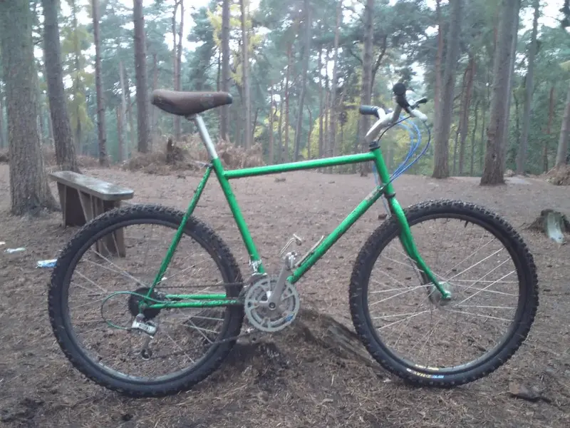

With drum-brakes being popular on tandems, I am not surprised that a builder who made tandems would also use them on their MTBs.
This is what Rod says of the braking on his Swallow Merlin as: "Awful. On/off, little modulation, would work better with 4 finger levers Im sure, but I dont like 4 finger levers."
My own experience with the Sturmey's was, whilst they were ok for road riding, I wouldn't want to use them on a steep technical off-road downhill, even with four-finger levers.
Sounds reassuring! My build will be 70mm sturmey drums and two finger levers!
I guess I'll be faster downhill than most 😂
