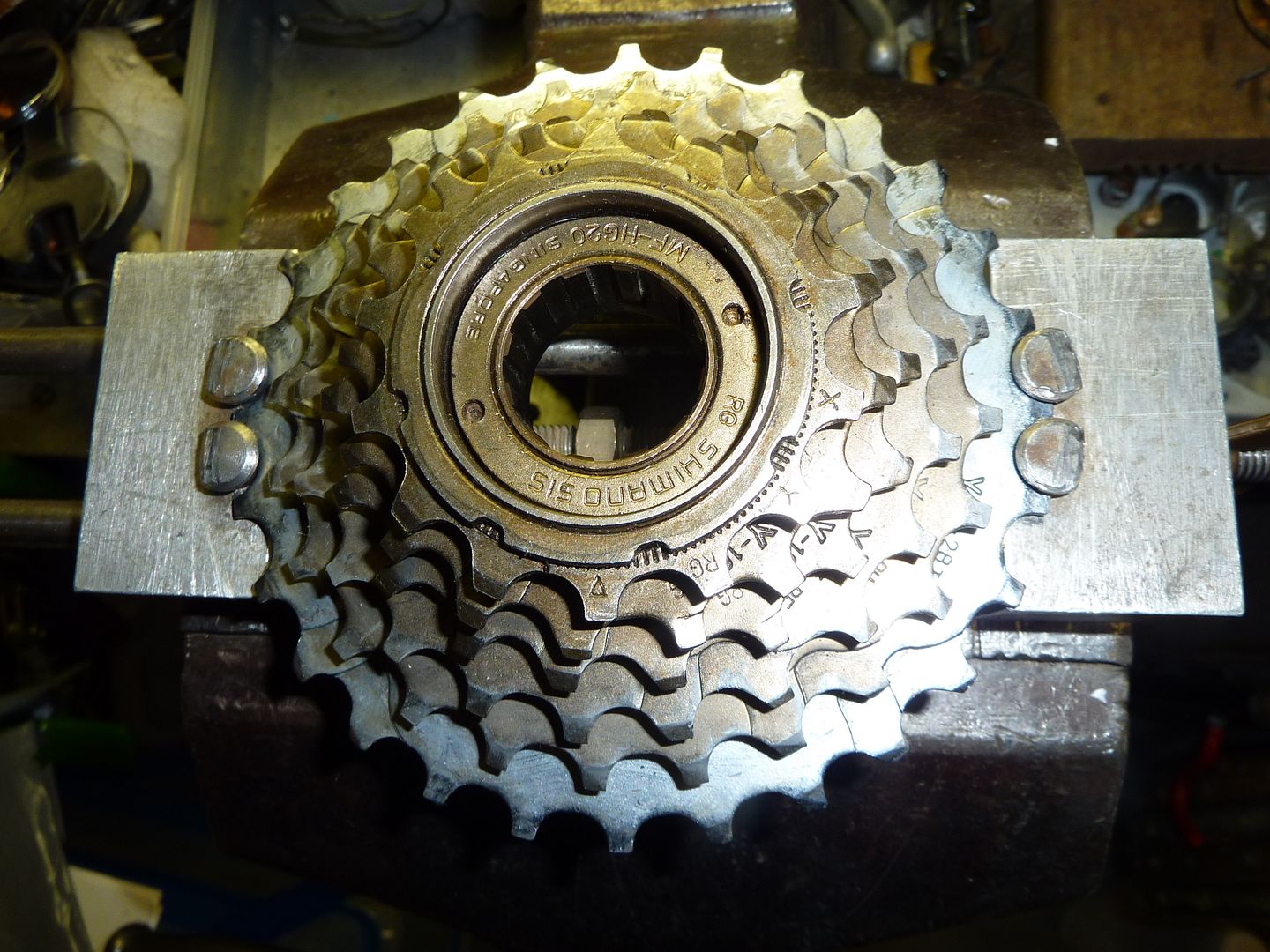

I have hot an old Shimano HG20 freewheel
I want to undo the cogs but
it seems to me that contrary to the maillard or sachs freeewheels, it is not the first cog that is actually holding first the freewheel but an independant threaded lockring with tiny indentations - see pic
Am I right ?
to me it is not attached to the first cog - I have tried to undo the first cog but nothing happens ( true I haven't been very energetic yet)
maybe not ? as Sheldon and other internet pages don't show any specific tool for that small ring ?
second question is , what is the internal profile of the cogs ? are they similar to Maillard , or proprietary ? and not at all similar to later HG cassette cogs ?
Am I right ?
Yes, you are right, If yours is similar to the one I've got- a Singapore-made HG. It looks to be so. You can get the lockring off (anti-clockwise) with a hammer/carefully aimed screwdriver. Under that, two banks of splines, one for the three bigger cogs, and one for the three smaller. Here's a photo... not a great one. hope it helps..

it does
it confirms my analysis :wink:
don't think its particularly well designed !
now I know that later cogs certainly won't be compatible and that I would probably be wiser to go for a 8 speeds sachs freewheel as I need one rather than a shimano one :idea:
