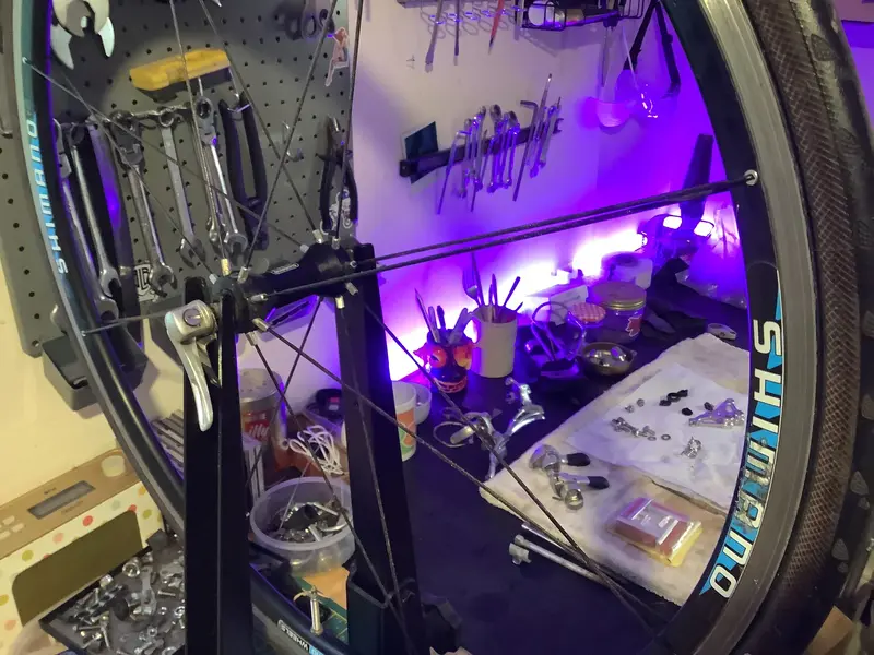

How to true Shimano ‘opposite lock’ wheels?

They are light, sound wheels but need care in tensioning. Do NOT over tension.
Each spoke pulls the wheel OUT TOWARDS IT - to true for 'lateral wobble'
Each pair of spokes has two opposites in each case - true opposite two spokes and adjacent two sets of spokes for 'circularity'
But start by putting release fluid on nipples and leaving for 24 hrs
Then investigate WHY it's out of true
Check all tensions and worry about those that are very tight
Keeping those in mind try slackening the spokes which are pulling those into tension
See if that gets you where you want to be
Then check all spokes for tension and tension all slightly if they need it
Bear in mind the late and great Bill Rayment's Rule of Tension: 'there are three tensions for spokes. Too loose. Too tight. And just right'
