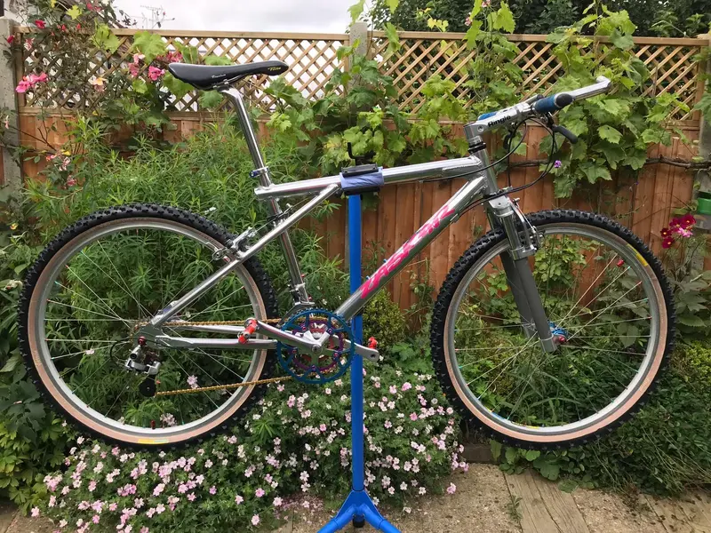

That all sounds sage advice. To be honest, it’s a garage queen now as I retired the poor thing years ago. It definitely earned it. Bought it new in ‘91 and raced / commuted on it for a good 15 years. It’ll probably get the heat and pickle fork treatment next time anyway. So thanks for the tip. 🔥🥒🍴

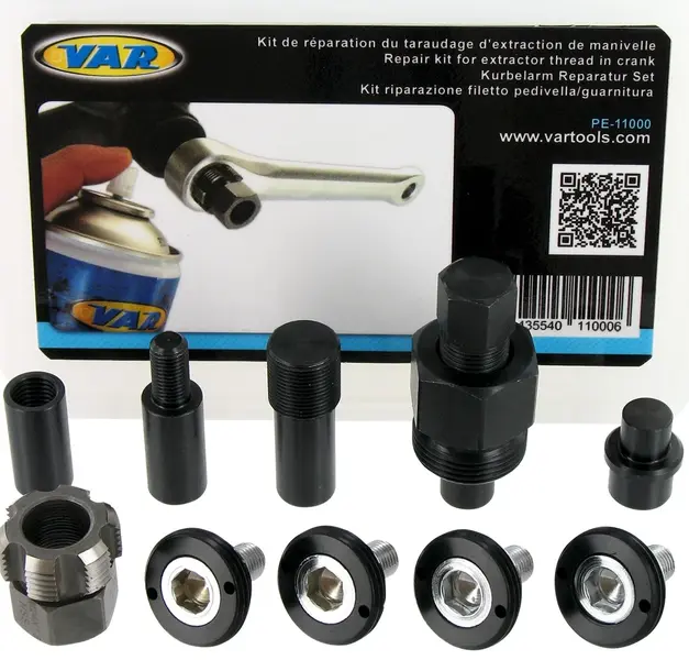

And if the thread is completely stripped out, there is a VAR crank thread repair system (PE-11000). This reams out and replaces the damaged thread with a new, larger diameter one. I have this, if anyone needs the job doing.:)
https://www.vartools.uk/m24x15-repair-kit-for-extractor-thread-in-crank-c2x36007258

That VAR tool makes so much sense. But £153 plus £34 postage? Yikes. Glue and bodge it is then…
