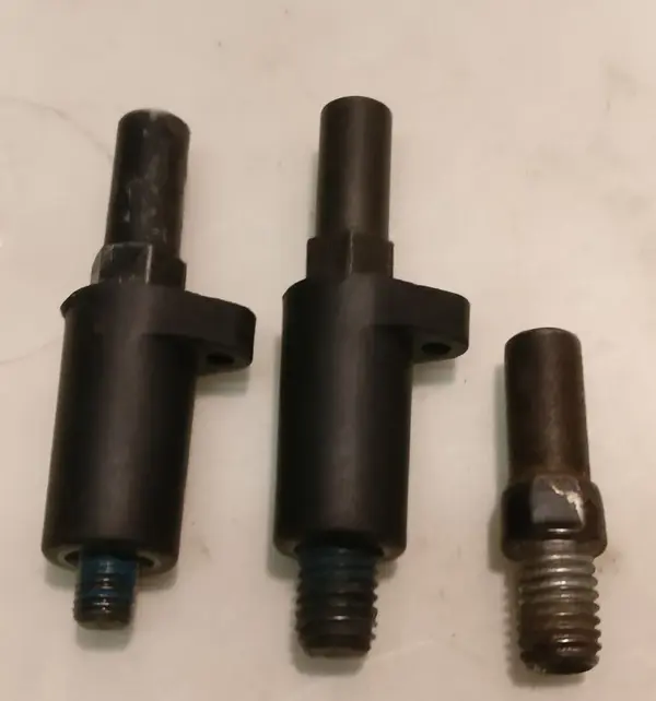

I have looked out my two spare sets of v-brake bosses and attached the image below. On the far right is a conventional v-brake boss for frames and some forks. In the middle, is a Marzocchi one with the same thread as the first (m8x1.25 as others have mentioned, I think?). The one on the left has what appears to be a 6mm thread, but much finer pitch than a standard M6. I suspect it's a pair of the middle ones you need as you previously mentioned trying a regular boss and it seemed almost right.

I can't seem to find any of the M8 type ones on eBay which makes it hard for me to establish a fair price, but how does £6 posted sound? That is, assuming you're still in need of these.
Hello, yes I am still interested in the parts, the middle set look like they will work, the thread is 8mm. £6 is very fair. How would you like me to pay? We will need to exchange addresses. I plan to put the forks on a 1995 Kona Cinder cone that I have owned from New.
